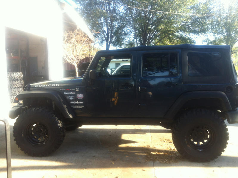

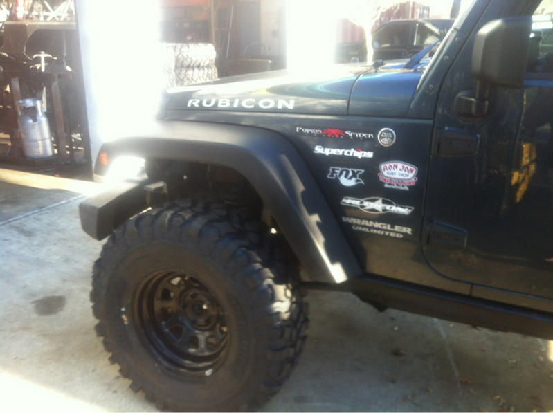

Don't let the cutting of the pinch seam worry you I have a 3 1/2 super-flex and a 1"body lift and still have to cut it everyone does

Originally Posted by JKingAround
<img src="https://www.jk-forum.com/forums/attachment.php?attachmentid=411059"/>
Ok im going to fit the tires today and cut the pinch seams and anything else that needs trimming
