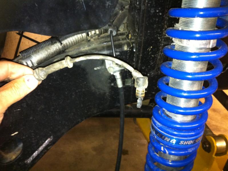

Default i checked the rear sensors today
i went out today and looked for the rear and front sensors. For the Rear sensors, if you look at the back of the brakes on the rear wheels you will see the sensors. The bolt holding the sensor in is a 8 mm. Make sure you pull the red clip out before trying to remove the plug from the sensor, i used a small flat head screw driver to work the red clip out and then used needle nose pliers to get the plug off the sensor. You have to take the plug off to get the sensor out for inspection. once i pulled the sensor out it looked alrght no cracks. so i cleaned it off and put it back in.
i am going to try the front tomorrow and see if there is any sign of damage. the wire goes behind the plate that protects the rotor and i didn't feel like taking the front tires off today.
But i did find instructions to get to the Front ones. So i am planning on taking off the tires and inspecting both sensors. I did get a code at autozone as well. It was U0125 that said it lost communications with a sensor, but it doesn't say which one. i found a list of codes on another site since they don't have them here any longer because they are copy writed material and that code is not listed anyway.
so it doesn't relly help find the location of the problem.
So if i check the front ones and they look alright i am goign to have to take it in to the dealer.
Not looking forward to that.
Front Wheel sensor removal installation
  • Remove tire
  • Remove caliper
  • Remove rotor
  • You will see the sensor at this point. Just follow the ABS wire down to where it bolts in just the housing. There is a single Allen head bolt. I forget the size offhand.
  • Remove bolt
  • CAREFULLY remove sensor from housing (they break easily)
  • Finagle it out of the hole in the dust shield
  • follow the cable up behind the shock tower where you will find a clip to unhook cable
  • Reverse directions to install new sensor being super careful when you insert it and be sure to keep debris from falling in the open hole.
i did see a pic out here in another post with the wheel sensor in it for the front. i put it here because other people have asked for it. see below.
Name:	wheel sensor.jpg
