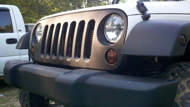

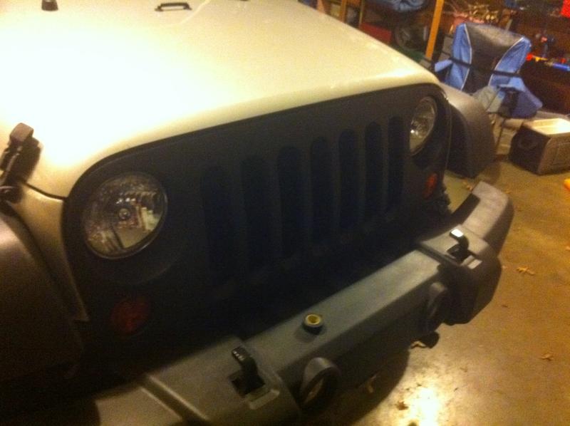

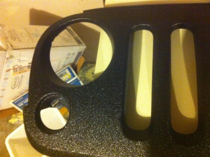

I used rustolium bedliner spray. I sanded it with 100 grit. And cleaned with alcohol. I used just one can. I didn't want it too thick.

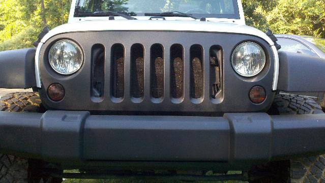

I also used the Rustoleum Bedliner in the shaker can. Worked great!

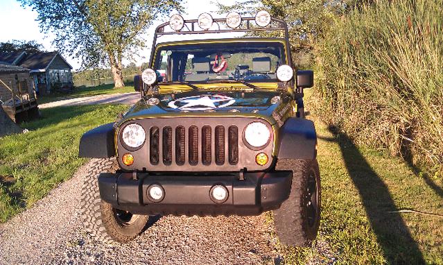

Got it done this weekend!!! Came out good!! So easy!

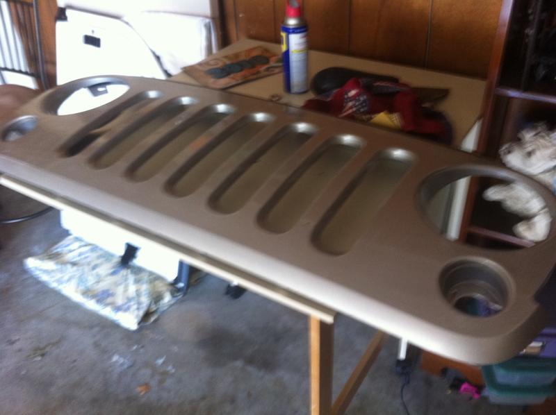

Just finised this and it looks GREAT!
