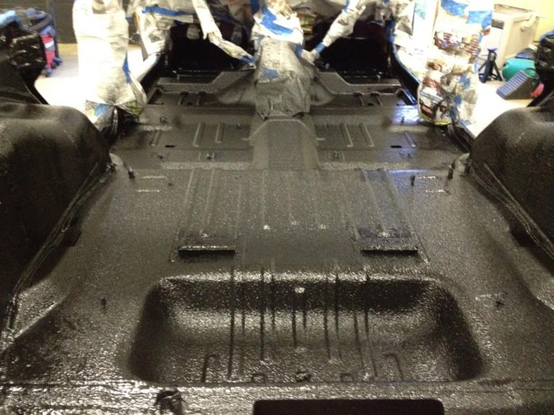

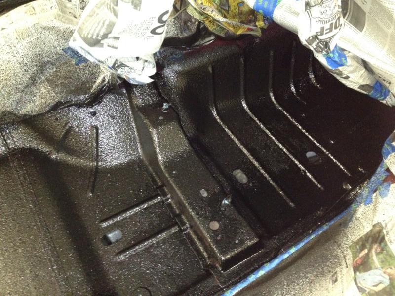

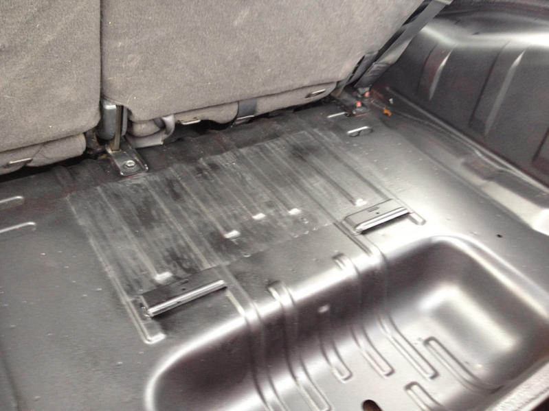

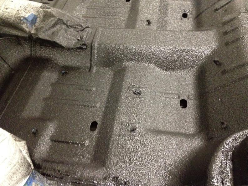

<img src="https://www.jk-forum.com/forums/attachment.php?attachmentid=321116"/><img src="https://www.jk-forum.com/forums/attachment.php?attachmentid=321117"/><img src="https://www.jk-forum.com/forums/attachment.php?attachmentid=321118"/><img src="https://www.jk-forum.com/forums/attachment.php?attachmentid=321119"/>
Roll on? Or spray?

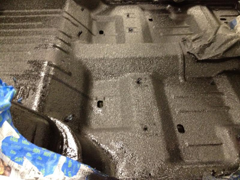

Only one I have... I resanded the area where the sound damping stuff was once I got ahold of a power sander. In this pic it looks off colored

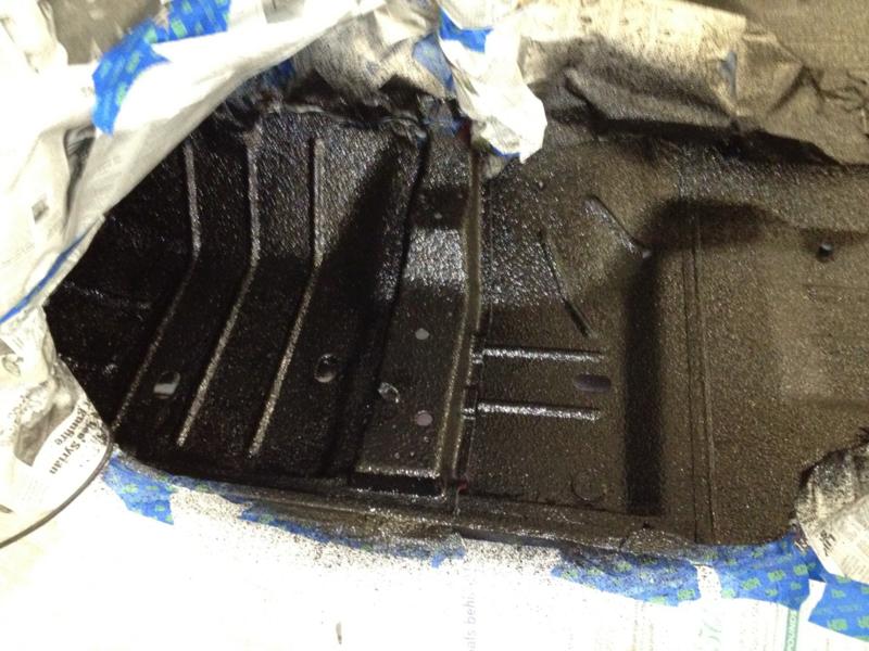

I used a gallon of Al's Liner with their spray gun you can buy to use with an air compressor. Worked great! I used an air chisel for the sound deadening stuff.
