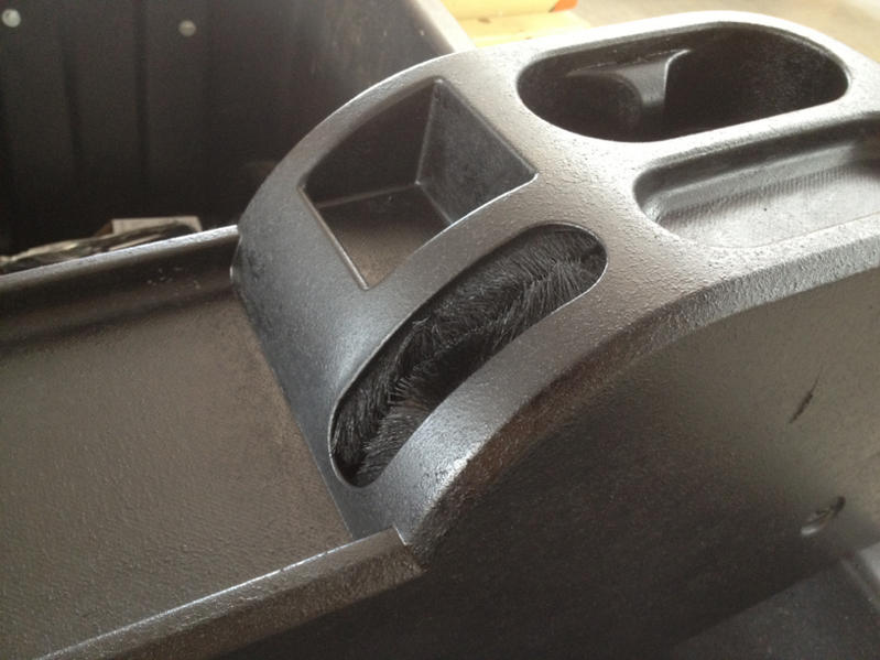

Powderburn's Avatar
Posts: 201
From: Austin, tx
Originally Posted by Sirisa0408
I am planning on bedlining my interior this weekend an next. I work two jobs so it will take two weekends with conflictimg schedules. I plan on getting a gallon and using a roller to put it on. My only concern is, how did yall cover the drain holes, and did yall sand down the sound/heat stuff under front floor mats and rear seat. This is a two door btw. Also what did everyone do with the compartment at the rear with the jack in. Did you bedline it also, and did you put the cover back on it. I will post pics of my progress. I stripped the carpet today.
I just finished mine this morning. I rolled the whole thing. You can control the texture by the roller you use. I plugged about all the holes. Then rolled over the ones i didn't and there is NO need to plug any hole. Wasted an hr ;(.
I bed lined EVERYTHING except the dash board. Evn did the middle console. Love it!
Spray is good too, but couldn't get one.
I spent $80 for the whole thing. Used rustolium
LOL center console too ... I love it! What next? I wanna see someone tip the whole tub.
