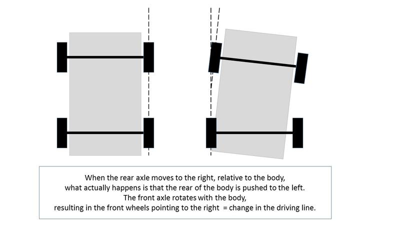

Jeeps, like any vehicle with floating axles, have less directional stability, hence the need for constant small steering corrections.
The rear axle – and not the front one – is the main cause.
When the rear axles moves up or down, the radius arm makes it move to the left or right.
What actually happens is that the rear of the body moves sideways, relative to the rear axle – the body rotates along its longitudinal axis.
As the front axle rotates together with the body, the front wheels point to a new direction, a bit to the left of to the right. Obviously, the result is a change in the driving line, a change that has to be corrected by the driver.
This sketch shows how it works:
Name:	Rear Axle Effect On Steering - JPEG.jpg
The effect of wind gusts cannot be eliminated, but almost all of the “snaking” can be eliminated by eliminating the sideways movements of the rear axle.

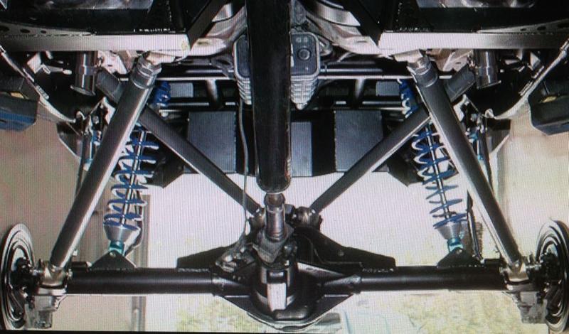

Triangulated 4 Links:
Name:	Triangulated 4 Links 001.jpg

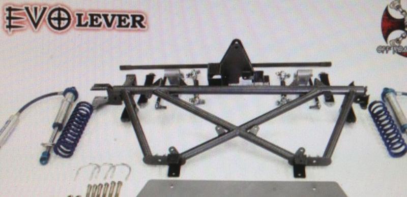

EVO Lever:
Name:	EVO Lever.jpg

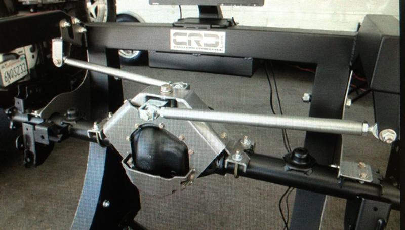

CRC Link:
Name:	CRC Link 002.jpg
The last one is what I have on my Jeep. It’s the simplest and least expensive, and it works.
