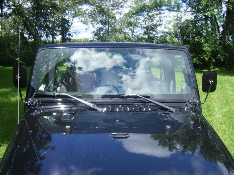

Can I get a close up of how you mounted yours. I mounted mine like th instructions show but I like your set up.

I took them off for snow and ice season to eliminate a possible buildup location.
I used the existing bolts on the front of the windshield, in the existing holes.
I put rubber/plastic bushings between the body and the bracket.
I put stainless nuts between the stainless button head bolts and the "pucks" that hold the arms. (to act as locks)
The mirrors were positioned "CJ style," so the RH was viewed through the windshield. The LH mirror was fully visible with the doors off, but the window frame would obscure some of it with the doors on. (which didn't matter with the doors on, since I still had the OEM mirrors on the doors) I had to line up the LH door accurately to get it on and off, since the LH Lange mirror was very close (but not touching) with the door open.

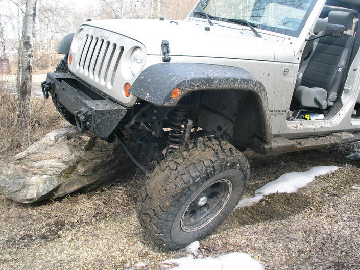

This is the route that I took. But I machined the ends of the mirrors so that they can fit in the side windshield mount holes.

This is on my old rig but I'm using the same mirror on this new one. Remove one of the bolts and screw this in its place
