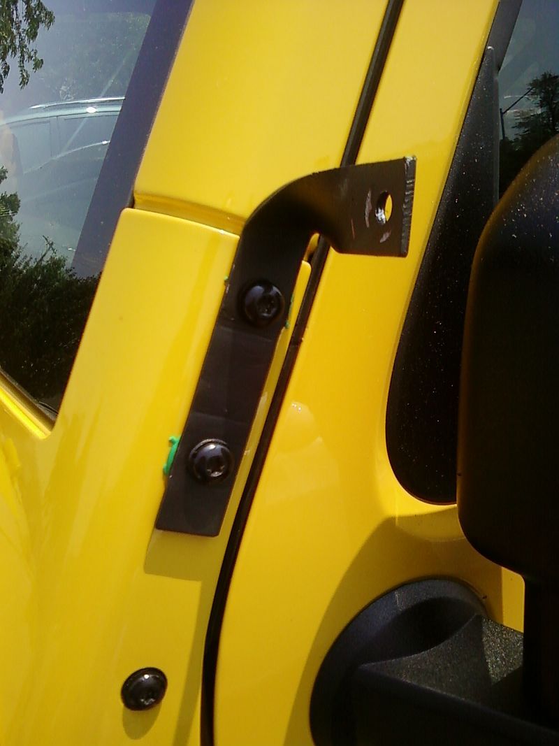

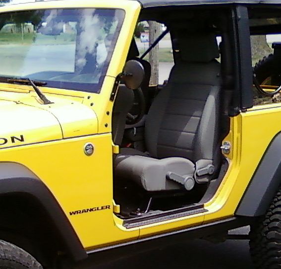

I researched this to death and couldn't find a solution that was good enough for both doors on and off. What I wanted was something that made the mirrors usable all the time. This I found was not to be so what finally did was made some mounts myself to bolt onto the side window plates.

This way when the doors are on I use the OE mirrors in the proper location and when the doors are off I use aftermarket mirrors I just bolt on with butterfly nuts and lock washers to the mounts. Clean and simple. Solid as a rock on the highway.

certainly looks like your on the right track here! but, why cant these be used with the doors on? not visible? what if you had them stick out further?
