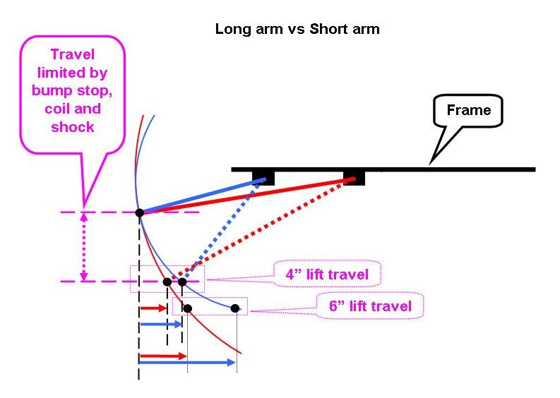

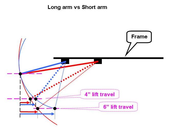

Long arms move the wheel & axle more vertically and along a flatter arc.
With 6" lift or more, this is meaningful.
Up to 4" lift, there's no noticeable change in ride feel.
I compared 2 similar Jeeps with similar 4" lifts, one had long arms. None of us -- the other Jeep owner, a 4x4 shop owner and I -- could feel a true difference.
This sketch illustrates the difference, and why a true difference exist only when the lift is over a certain height:

Am I correct in seeing that the long arm kit would be less squirrely on road because the arms would be more parallel or level?
Read post 41... Up to 4" lift you won't feel a difference.
