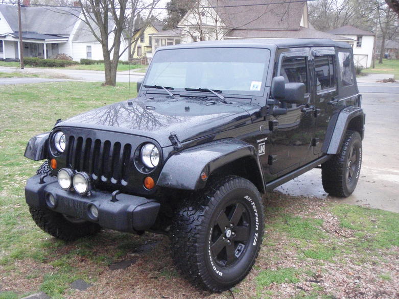

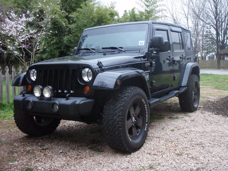

I'm running the 305/65/18 BFG All Terrain KO on my stock Sahara rims. I did have to install 1 1/2" spacers for clearance. I do have a 2" FT BB lift - but seems to me you could run these tires with no lift. They are 33.8" tall. aren't the Rubicon tires nearly 33's?
