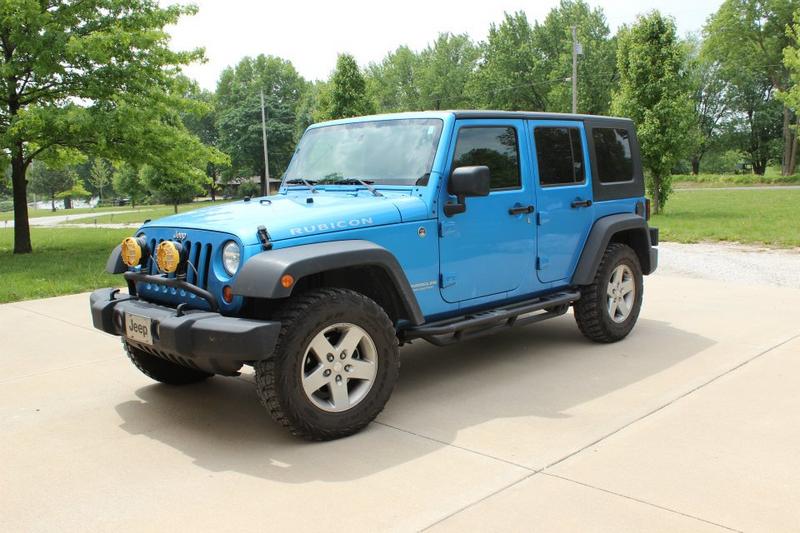

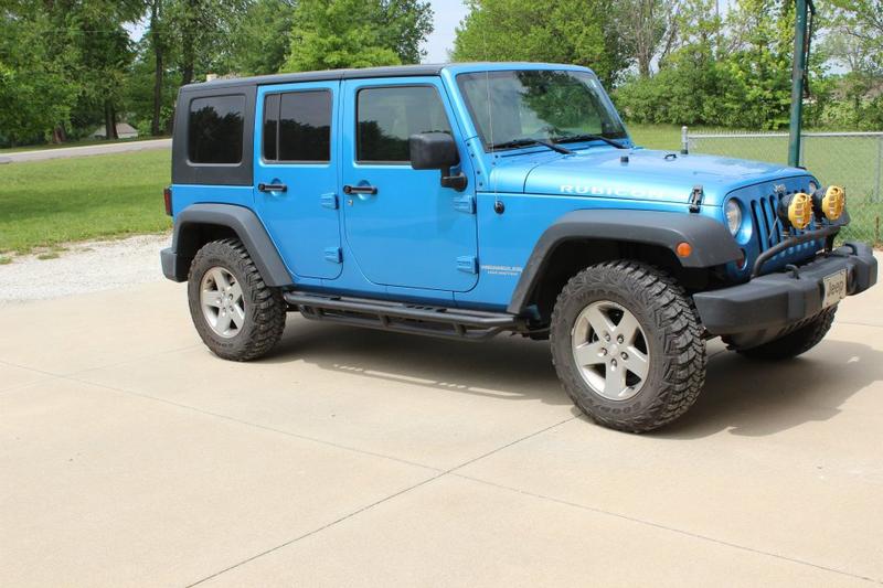

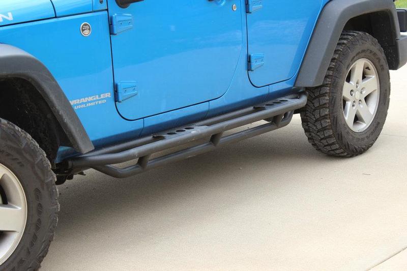

Here's some pics:

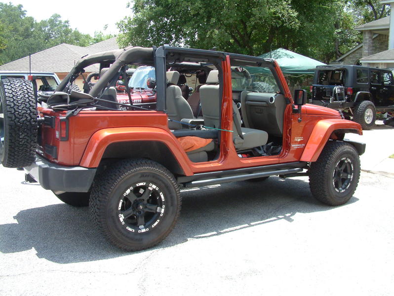

I just purchased and installed the SRC Side Armor from Smittybilt (76634) on my 2010 JK Unlimited Rubicon, and didn't have too many problems. On both the driver and apssenger side, one of the mounting holes was off by about 1/16th of an inch, but it only took a few minutes with a dremel to widen the hole so it fit. I don't think this is a manufacturing problem. Because these attach to the frame, I believe there is a bit of variability in the vehicles themselves. Here are a couple of pictures.

I had similar issues with all my Smitty products, however all my issues were able to be fixed with a dremel and a grinding bit.

I disagree with your statement about variability with the vehicles, if this were the case, it would be an issue with EVERY manufacturer that used these mounting points, not just SmittyBilt. I think that is the answer(excuse) they give everyone and tell them to just use a dremmel to cut it a bit. I believe that this is a manufacturing quality control problem, and one that this company has been burying their heads in the sand for years without correction. This leads me to believe that quality is not a priority with them and thus I will not be buying any more of their products.
With that said, once they are on, they are pretty solid.

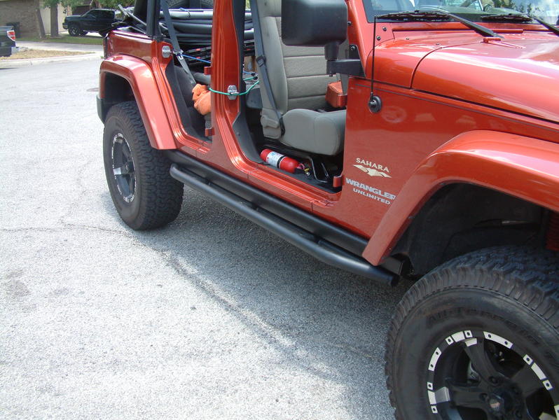

For $295 you can get ACE rails and have the quality and fitment of the "top companies" for the price of, well, you know...
