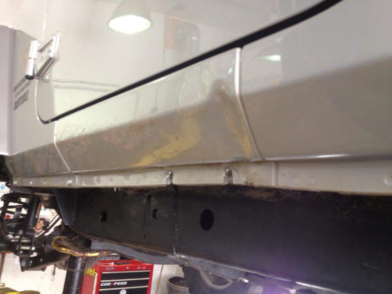

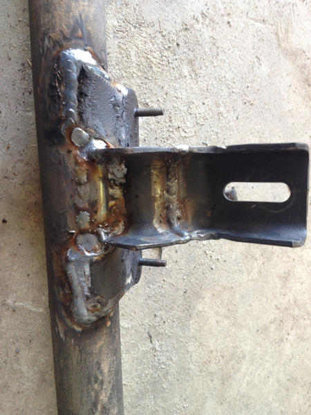

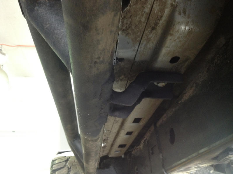

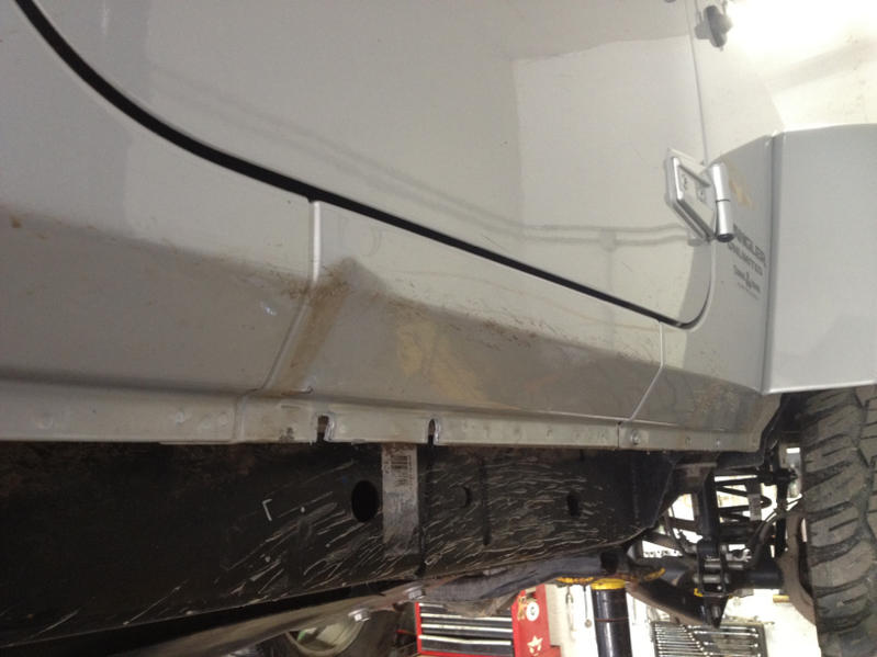

Lame product!! Buyers Beware!!
I just purchased and installed the SRC rocker guards to Protect my brand new JK. The install went fine, then went out and did some minor wheeling and as you can see in the pics, both passenger and drivers side rocker panels got mangled!!! Didn't dent or even scratch the guards, but they sure flexed enough to dent the piss out of my rockers. I'll never buy any Smittybilt products again, Ever! I wasn't expecting bomb proof performance but this is ridiculous at best. Will be contacting them ASAP and hopefully reach a resolution. Going to my first big Jeep event this weekend the Fall Crawl in NH. Went over to my buddy's shop this morning and had him fabricate brackets to stop guards from flexing. He did a great job and we'll see how they hold up this weekend. I don't understand why Smittybilt doesn't put a 3rd bracket for off center body mount?? Hopefully this saves someone the headache I'm experiencing!

Wow, just installed these. Hmmm, CRAP!

I had fitment issues as well when I installed these on my wife's 4dr. But I figured the bolt on part bent slightly during shipping. I had to install front location about half threaded then pull rear out to get it all to line up
