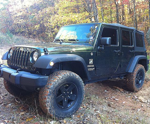

This is mine with a 2.5 rough country bb. It has 35 12.5 17 BFG MT's. Love it!!!
