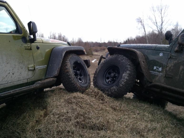

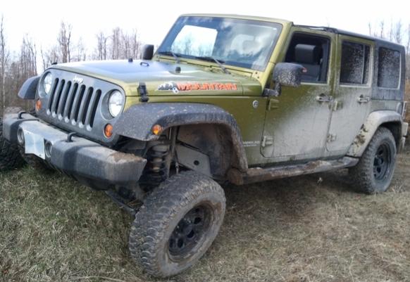

You don't 'need' them and will only require them once you start wheeling and getting used to what you can and can not do with your new lift. I have the exact same lift as you are installing. I have a daily driver and do light to moderate wheeling. I bought disconnects, but only because I bent one of my links and had to replace it, so basically I got them instead a little earlier than I had planned. Here's some pics of what your lift will basically look like.

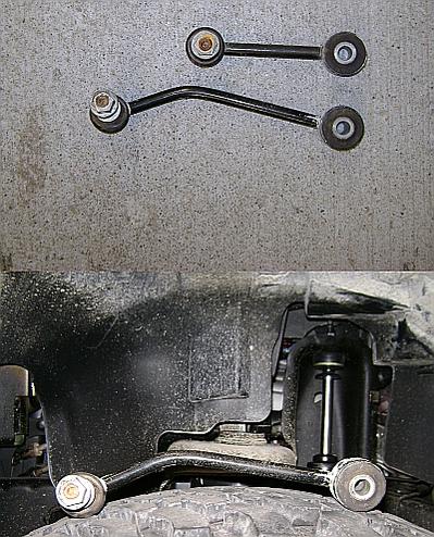

They were pretty affordable and easy to install. JKS' are very popular if you have the funds. The ones I got were the Teraflex ones, I think I had gotten them on sale for around $120. Like I said it's only cause I bent one of my links.
