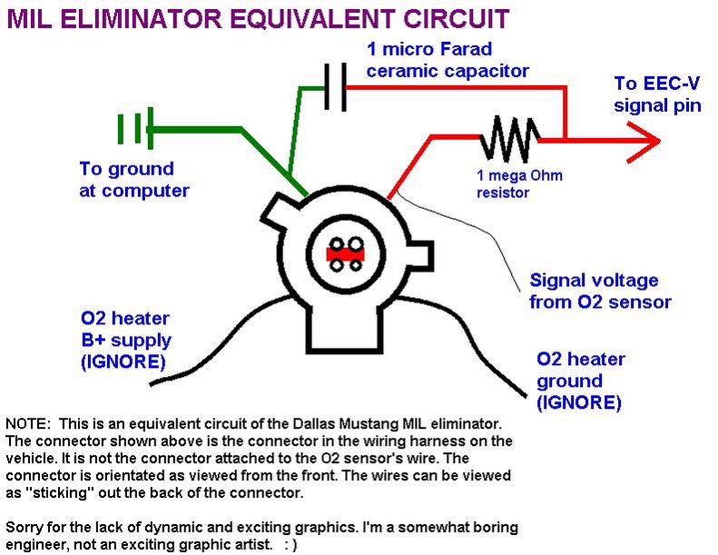

I have them on my mustang and they are called MIL Eliminators... (Malfunction Indicator Light)
It's a simple 2 component circuit really..
MIL Eliminator
If you are one of the people with '94 and up MN12, and thinking of making a straight exhaust with no catalic converters, you may run into problems since your model car has OBDII sensors behind each cat. If you remove the sensor computer may be getting wrong readings.
But don't worry.
There is a special device called a MIL Eliminator that you can get at www.dallasmustang.com ($60 + S&H), that will reroute the signal correctly to the computer without having the OBDII sensors in.
The device just plugs into the back of the rear O2 sensors and they send a signal that tells the computer that everything is ok, just as the O2 sensors would if the cats were there.
* - Also, if you are going to remove all the cats be careful that you have enough backpressure or you will lose low-end torque. I have heard this is a common occurence when you gut or remove the cats. You can put one 3" in/out Flowmaster or a Resonator where the third cat used to be to fix this.
There is also a way to build a circuit that will work just like the MIL Eliminator.
Here is a link to the diagram that you can build it on your own if you are good with electronics.
Make a circuit that reads the voltage of the first o2 then injects a corresponding voltage into the harness connection for the second o2. A couple of diodes and resistors is all that is needed.
