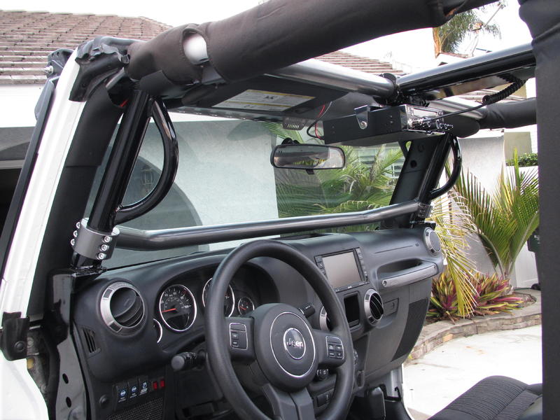

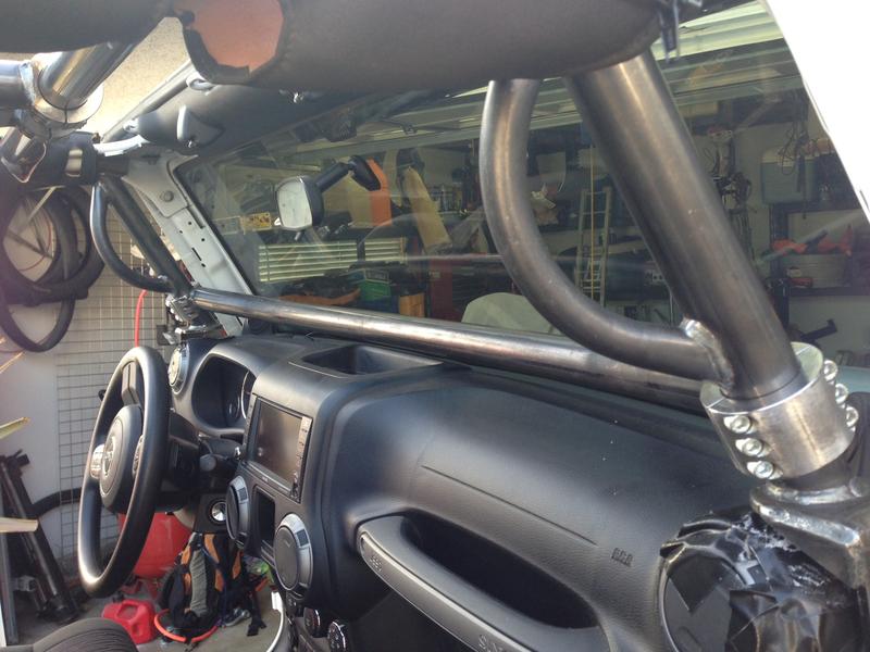

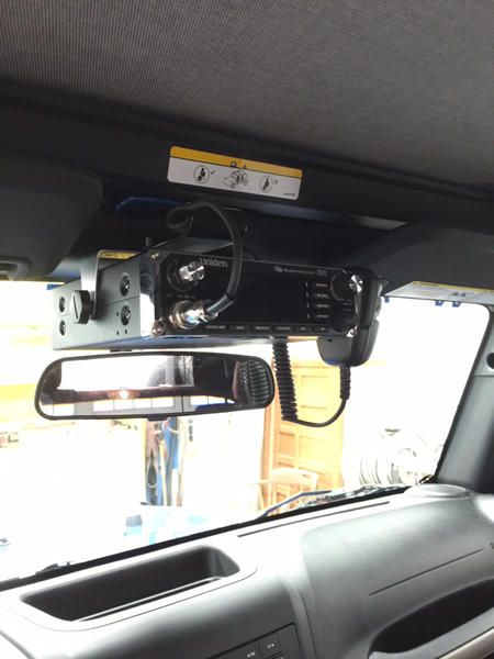

I like the custom overhead setup detailed in the first response,, the one with the shelf standards!! Seems like a cheap way to get it done.
I have a similar suggestion. I recently installed a Rock Hard sport cage, and found a suggestion to use a KC Highlights light mount for a way to mount the CB to the center of the upper cross bar. I think you could call Rock Hard and just purchase the single upper crossbar, mount it to your stock cage (which it does anyway and is supper easy),, then use the KC clamp to mount your CB to the front crossbar. Although I like what was posted earlier,, I think this would look much cleaner and add to the rigidity of the stock cage. Although it will definitely be more expensive. You might be able to get Rock Hard to sell you that upper cross bar for $100. The wiring was extremely easy. I ran the power wires behind the windshield and a pillar plastics to the drivers side and ran the antenna the same way down the passenger side.
As far as I know, this has never been done before, which doubles its cool factor!!!!
KC HiLiTES Universal Light Mount Tube Clamp Bracket
