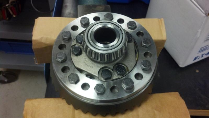

I've read good Truetrac reviews and I've read about disasters. I think most of the problems encountered can be traced to improper installation of the ring gear. Earlier Truetrac's holes were mismatched for stock Jeep ring gears. Some installers had to drill their own holes to fit. Also, using bolts too small for the holes will cause the ring gear bolts to loosen and fail. Today's Truetracs come with different hole options to better adapt and most aftermarket ring and pinion sets are designed to match.
