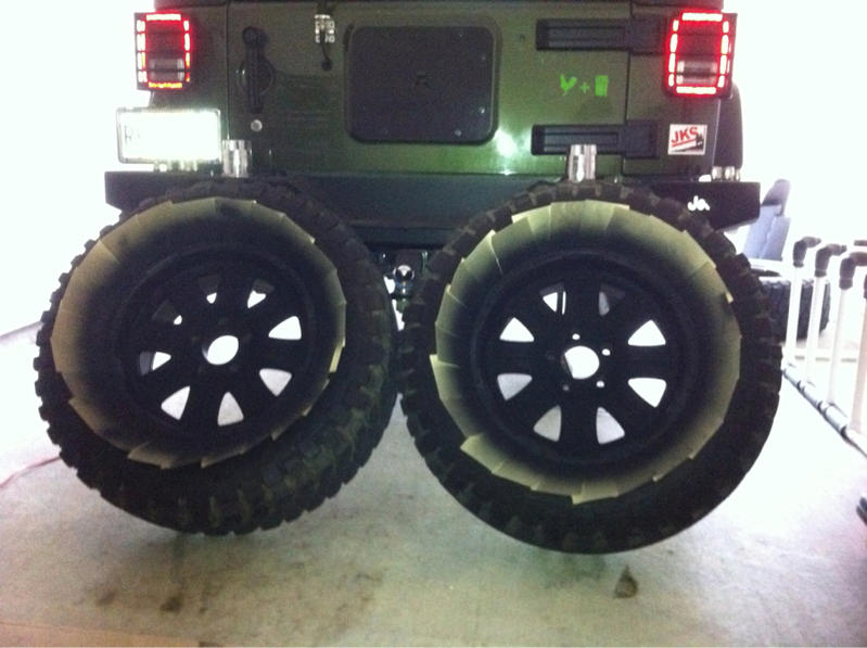

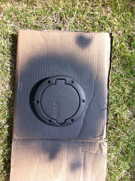

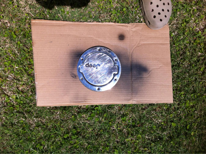

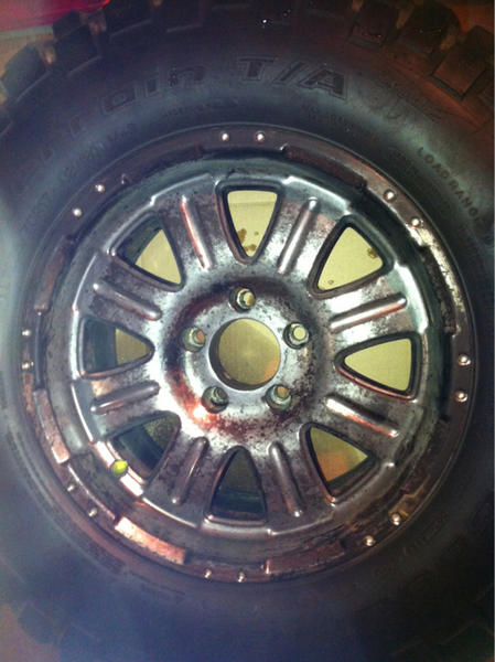

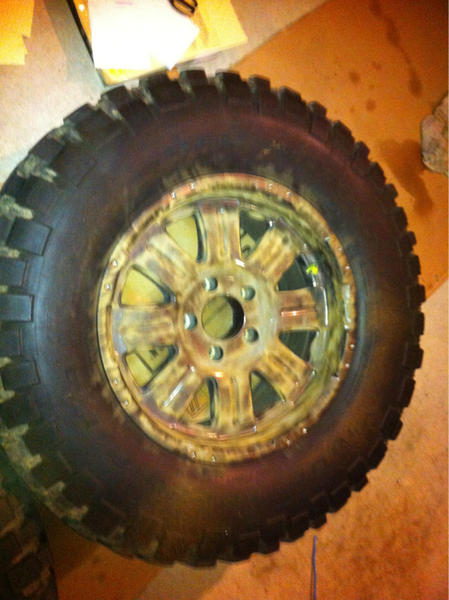

I did this with Bed-liner to my black chrome wheels and chrome gas cap. You need a wire brush/drill/Brillo pad or fine grit sand paper and bed liner or paint. Use the wire brush and take the chrome off to the metal. If you don't get a majority off, it will not sick to the chrome. Then, use a Brillo pad or sandpaper to get the hard to reach areas. Clean up with paint thinner or mineral spirits. Then shoot paint or bed liner. Here's some pics of my doing:
