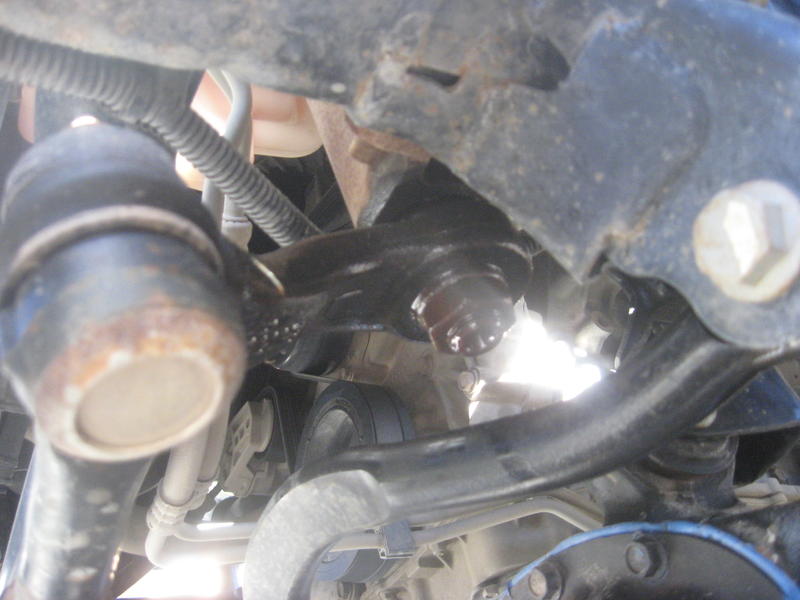

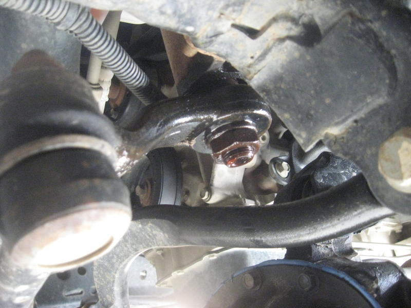

BINGO i found something that might help. well let me tell you something. i have the same problem as you if i hit a bump or the front end flexes a bit i hear the clunking sound. i started hearing the noise on my way out of AZUSA CANYON OHV. the clunk was coming from the front driver side almost from the floor board. in the morning i went to the garage and found some fluid on the floor i thought it was my 1993 accord and found the fluid was coming from the pit arm/steering box. but still why would there be clunking noise. HELP PLEASE i dont want to go to the slealership

Old Jan 3, 2012 | 07:52 PM
cis911's Avatar
Posts: 538
From: CAMP LEJEUNE, NC
wayoflife? anyone?
Old Jan 3, 2012 | 07:55 PM
cis911's Avatar
Posts: 538
oh and my set up is in my sig. i also found out the i could also hear the clunking noise when i rocked my jeep from side to side. i tightened the studs on the rough country quick disconnect and i could still hear the clunk connected and disconnected.
