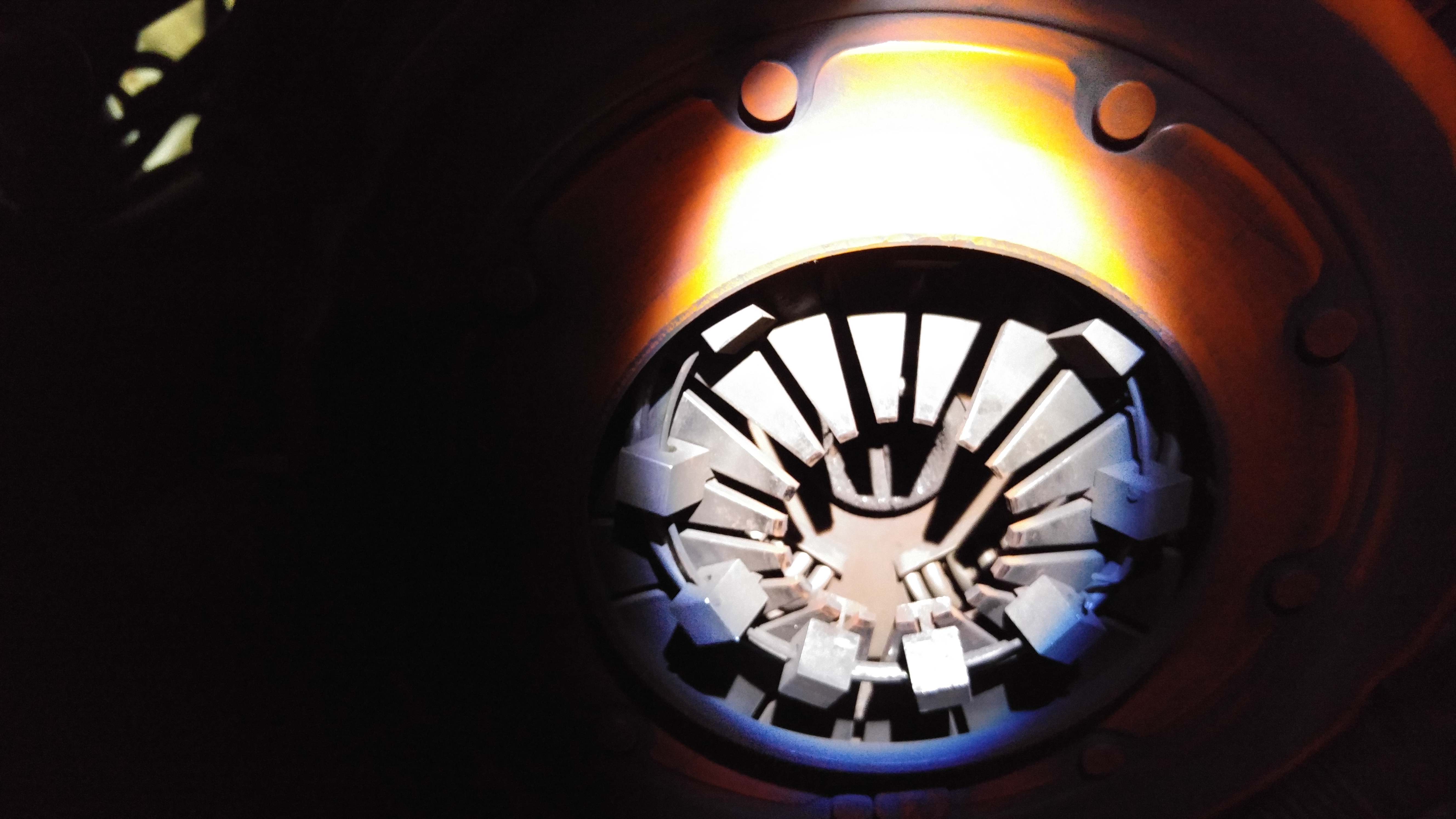

Take a look at my attached picture. I have had the same problems as you. Centerforce center balancing ring was stuck in the housing of the clutch in stead of free floating.
