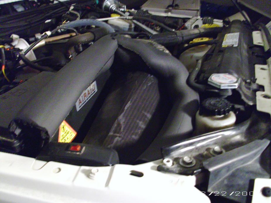

No, they dropped the ball on this airbox intake. Just as many people on here have hydrolocked with the stock airbox as cai's. Part of the problem is that the serpentine belt throws water directly across the underside of the hood into the opening of the stock airbox and right on top of cai's. Unless you do what I did and block the throw of water off the serpentine belt. I blocked in the front of the cai aswell.
Attachment 36076
Can you please explain how you did this cause it may be the solution I have been looking for!
