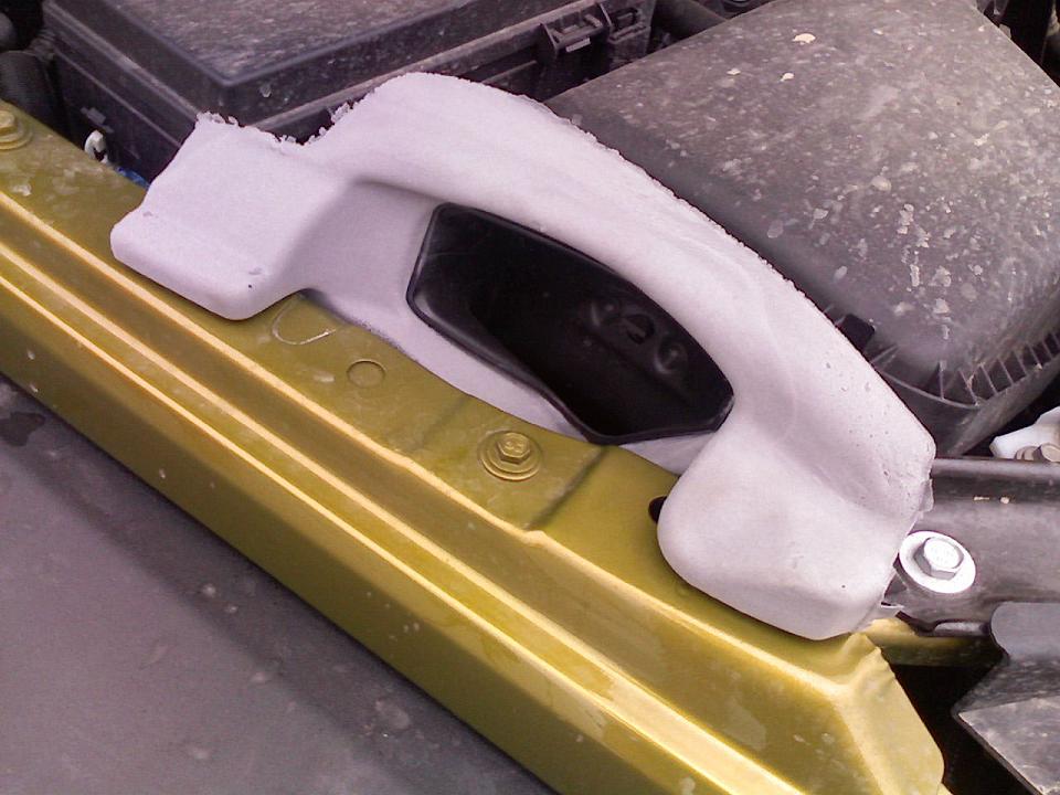

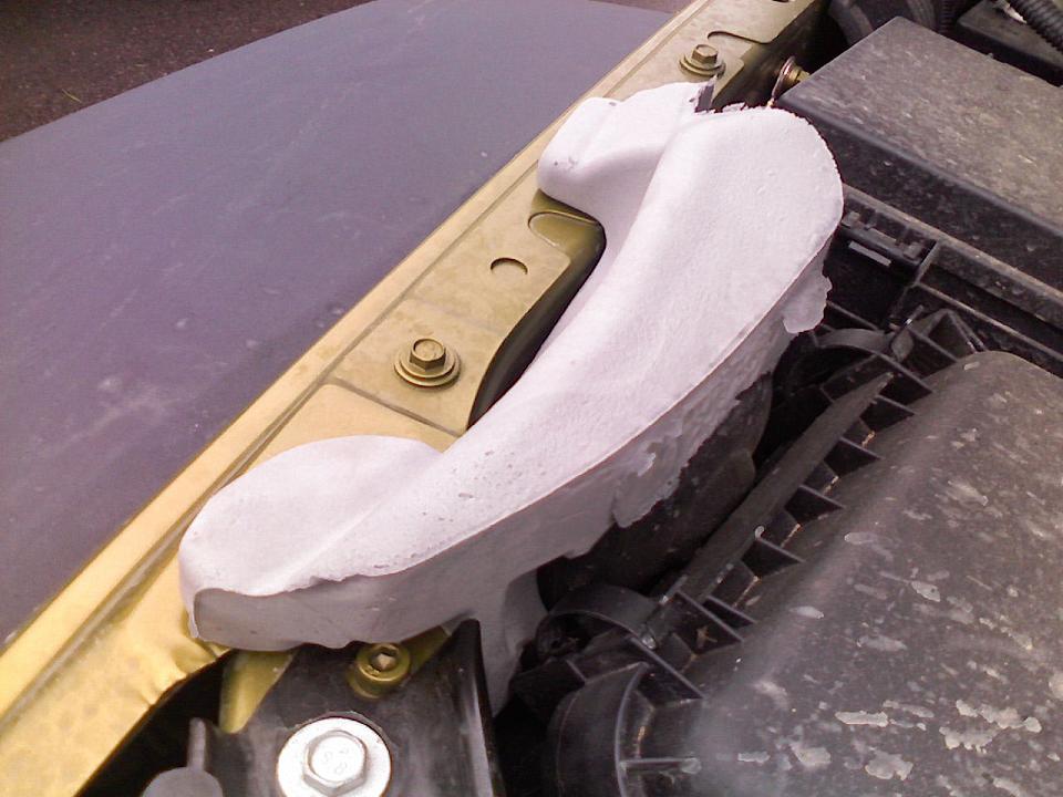

Thumbs up Got the part
Well, I finally got, and installed the part. It's a really simple piece that, once the hood's closed, creates the primary intake from the side of the hood, and blocks air from the rest of the engine bay.
$12 part and 30 second install later, here are pics.

Well how does it do? Can you paint it? Have you thought about putting a
K & N filter in the stock box?
