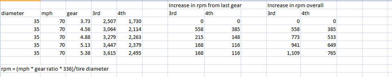

Edit: Here is a chart for 35s too. Just for an automatic.

I'm not sure where you got those charts but I was referring to what stock rpm is with stock gearing. Then look at recommended gearing and what the recommended rpm is
If you look at that is recommends that even stock 32 Rubicon size of tire is too high geared and a lower gear is recommended.
