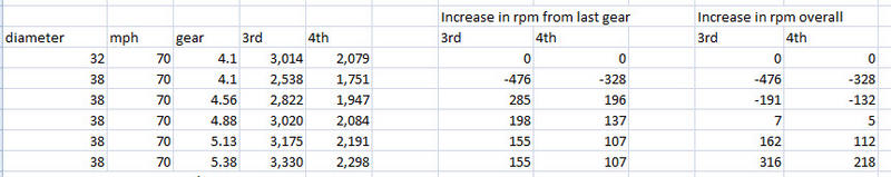

I made the charts. The OP stated he has an auto with 3.73 gears. The chart shows what rpm his jeep will run at with those stock gears and and 33s.
The chart just shows what the rpm will be in 3rd and OD given the different gearing. It has nothing to do with what is recommended.

It's calculated with the formula shown on the image. I believe it to be the exact formula that the proven charts where created with.
The formula is:
Gear ratios for an auto is: 1st = 2.84, 2nd = 1.57, 3rd = 1, 4th = 0.69
rpm = (mph * R&PRatio * 336)/tire diameter * gear Ratio
So the RPM on 3.73s with a 33" tire driving 65mph in 3rd = (65 * 3.73 * 336)/33*1 = 2469
Exactly what the so called proven charts show.

See my other post for the formula.
I notice you have an automatic rubicon with 38 inch tires and 5.38s.
Going 70 mph with 32" tires and stock 4.1 gears your rpm in OD should be about 2079
Put on a set of 38s without a gear change and your rpm will drop to 1751 to do the same speed.
then go and put in 5.38s and your RPM should be about 2298 in OD.
Here is a diagram showing you all the different rpms you would have had depending on what ring and pinion you go with:

True, the chart I uploaded only shows you rpm for 3rd and OD. If I was to recommend for 33s(and and auto) I would say 4.56 for better gas mileage but probably should go 4.88s. For 35s I would say 4.88 and 5.13s. Some say 5.13s are too small for a dana 30.

Oh for fuck sakes, take that formula I gave you and run it through any gear size and tire size and then compare the rpm with your proven charts and you will find its exact. That's all I claimed
I doubt your tires are exactly 38" and your speedo may not be accurate either.
