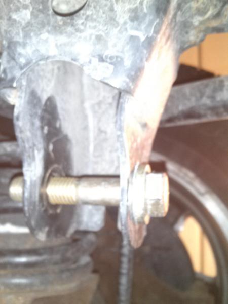

Guys, did the look over in planmans right up. Did not notice anything. The track bar was torqued at 125. So I removed it to check the bushings, it looks good to me, not exactly sure what to look for, maybe a little rusty but the rubber looks good. These are the bolts I replaced the factory ones with. Just got the size off a post somewhere in here. There are still threads within the track bar. Here's a pic. Would you consider theses ovaled out?

DW did occur before I replaced these bolts.

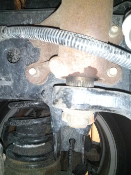

Did forget one thing, I did notice what looked like some leakage around the Pitman arm.

The holes look fine, and that isn't much leakage.
