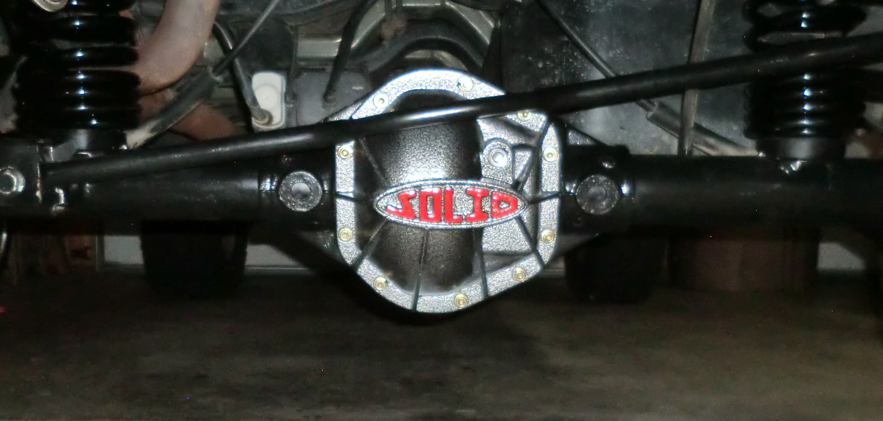

I just finished putting on a Mopar 2in lift and with that lift I added the Teraflex HD adjustable front Track Bar.
It seems the Solid covers with those reinforcement fins don't play well together with the TF Monster Track Bar. I'm getting rubbing clanking and creaking sounds anytime I go up/down small hills and hit bumps. It seems there may be too much of a good thing going on with these Solid HD covers.
I may change these out for the slimmer profile Teraflex covers.

If your trackbar is hitting the "fin" thing, you can shave it down. My trackbar contacted mine as well, I simply shaved a little off. I would start there before I bought an entire replacement, but I like my money... It's hard to tell in this picture, but the top right fin is the one I shaved.
I was thinking about doing that but wasn't sure if that was going to be enough of just trimming the rest of the fin down or if it would continue to hit depending on the amount of flex. I was thinking it was going to suck if my flex ends up being limited on one side by my diffy cover. I haven't even tried out those front quick disco links and figured the problem might get worse if I did.
