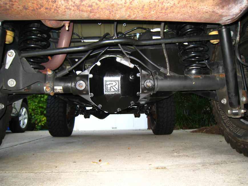

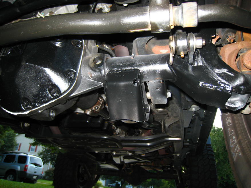

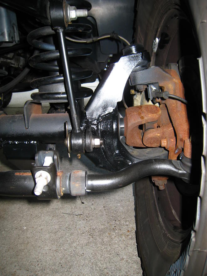

I do not have any reason for supporting Riddler other than they were driven over by a huge earth mover on YouTube and didn't break and I currently have them!
Does the previous poster notice anything in the second and third pictures!

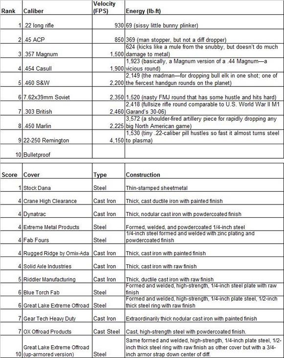

x2 on the Riddlers. Almost bulletproof. Here's my summary of the JP Magazine test. Probably not very scientific, but impressive anyway. The Riddlers are very stout, especially considering the cost.
Too bad they didn't take a shot or two at the ARB diff covers. I guess I will next time I see one.
