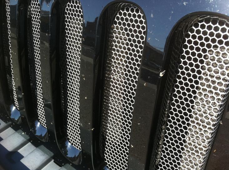

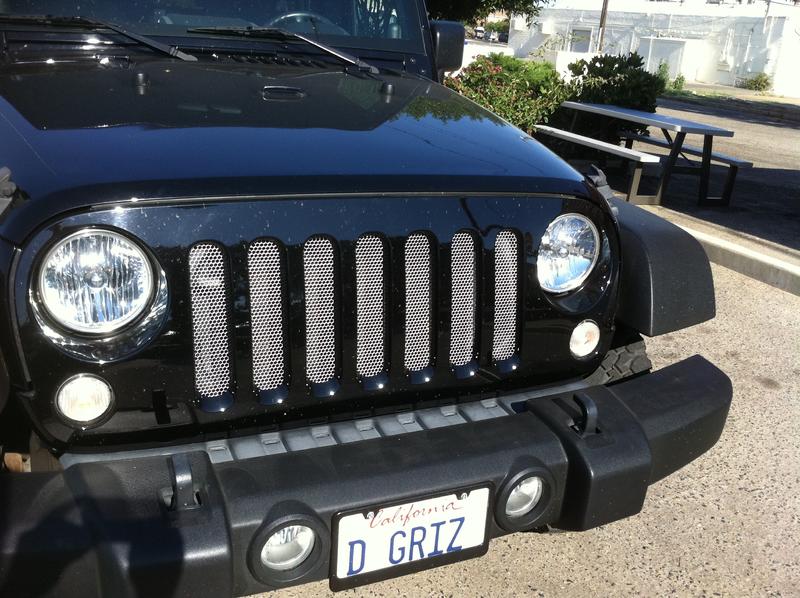

Perf metal DIY grille mod:
Name:	Grill Mod 001.jpg
ID:	389212Click image for larger version
Name:	Grill Mod 002.jpg
I bought mine from a local shop that makes it. I ended up having to buy a whole 10' x 4' sheet though but sold the extra to some friends to cover the cost. After I cleaned it up real good to get all the oils off of it, I used self-etching primer and then silver paint over that. It's been over a year now and it's held up good.
