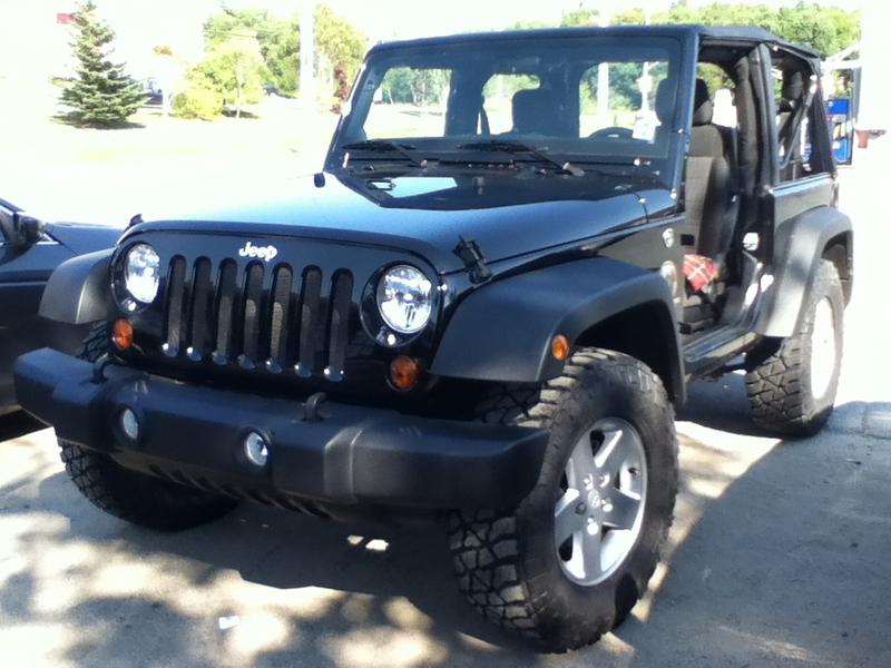

I just put 285/70/17s TSRs on my 2011 6spd with 321s. Once on I jumped in expecting a loss in power, I didnt feel it, so I took it out on the highway for a 10 minute run, I didnt notice any change. With my old wranglers I rarely used 6th because it was usueless on hills and with the new tires it's pretty much the same I didnt notice any difference at all from my old tires.
Name:	2012-08-27 16.23.17.jpg
Attachment 358762
Exactly. I only noticed a small difference after going to 35's. And the difference isn't crazy at all.
