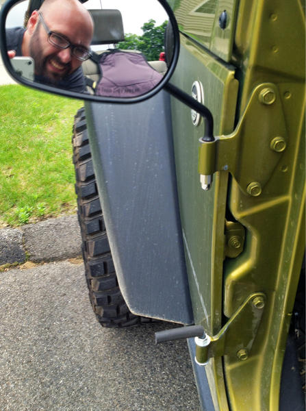

X3 they work great

Originally Posted by The Skinfather
X3 they work great
Are those the Harley mirrors several people have mentioned? If so, how much did they run you? I like that option, both for looks and for not having to remove my factory mirrors or buy a dedicated set of replacements to use the ditech mounts.
I got my Harley mirror for about $30. I went with the mid-size mirror so it's a bit smaller. Works great and doesn't shake...
