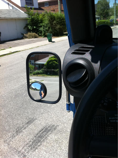

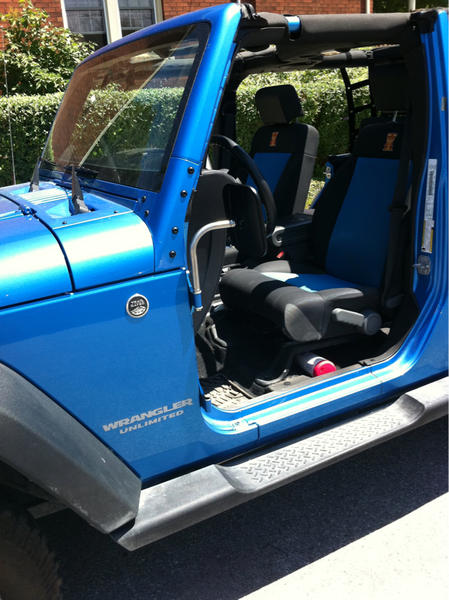

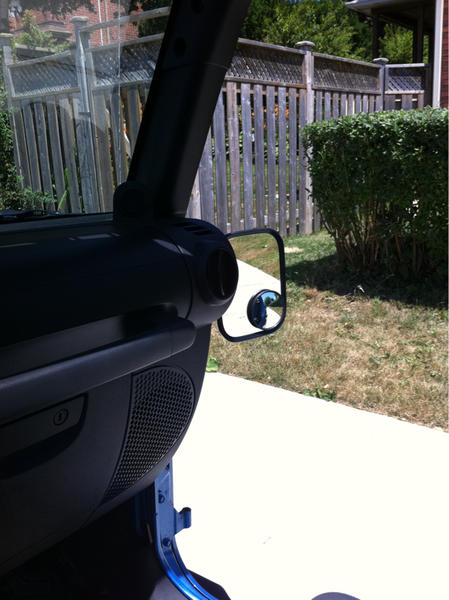

Made these a wile back, they work great but I think I'm going to change the mirror parts to 5-6 inch round convex for better viewing

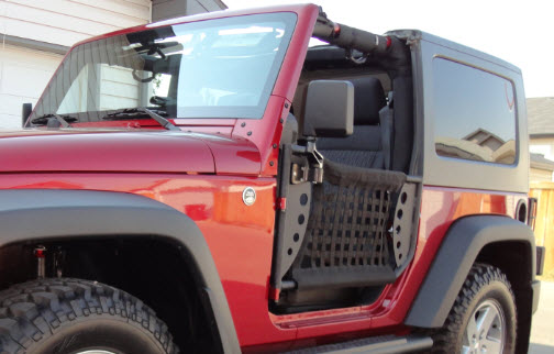

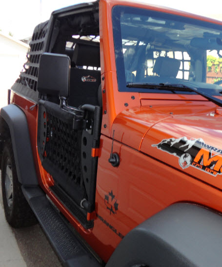

I struggled on my 2010 with the BODY ARMOR MIRRORS FOR TRAIL DOORS 5126 from Quadratec until I moved the doors to my 2012 and figured out if you don't extend the mirrors all the way it pretty much stops the vibration. They do need to be adjusted every couple of days or so but, they do work and look good. A blind spot convex mirror on each one helped as well, I now have great vision.

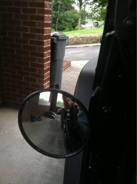

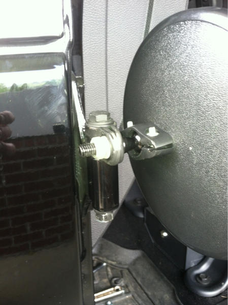

Added these, $9 at advance and bolts and nuts from the junk drawer in the garage.
