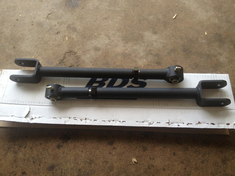

Look what showed up today.

From: CT
Man that was quick. Should be easy to install.
It took me 2 hours and I just finished it up.
