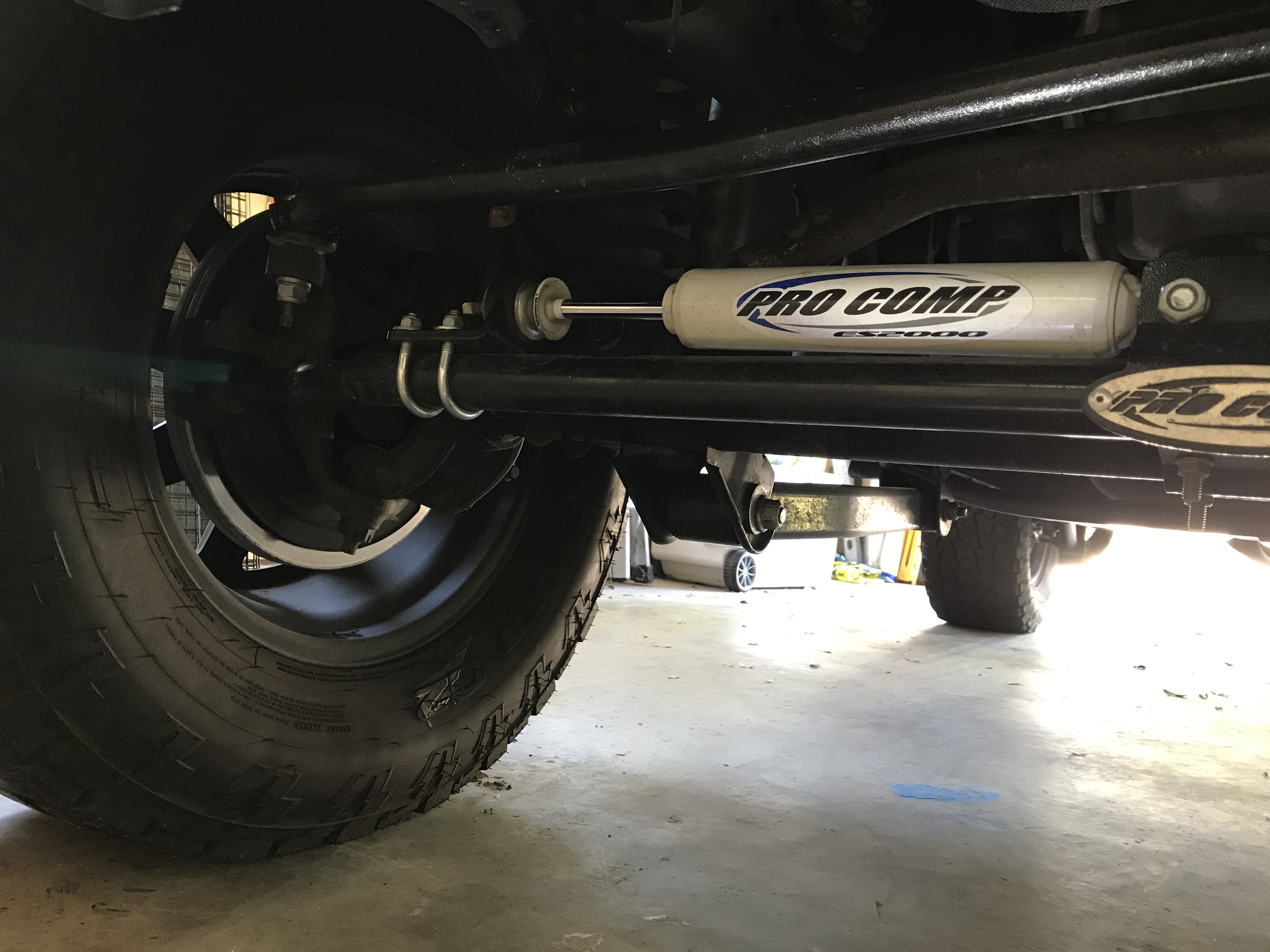

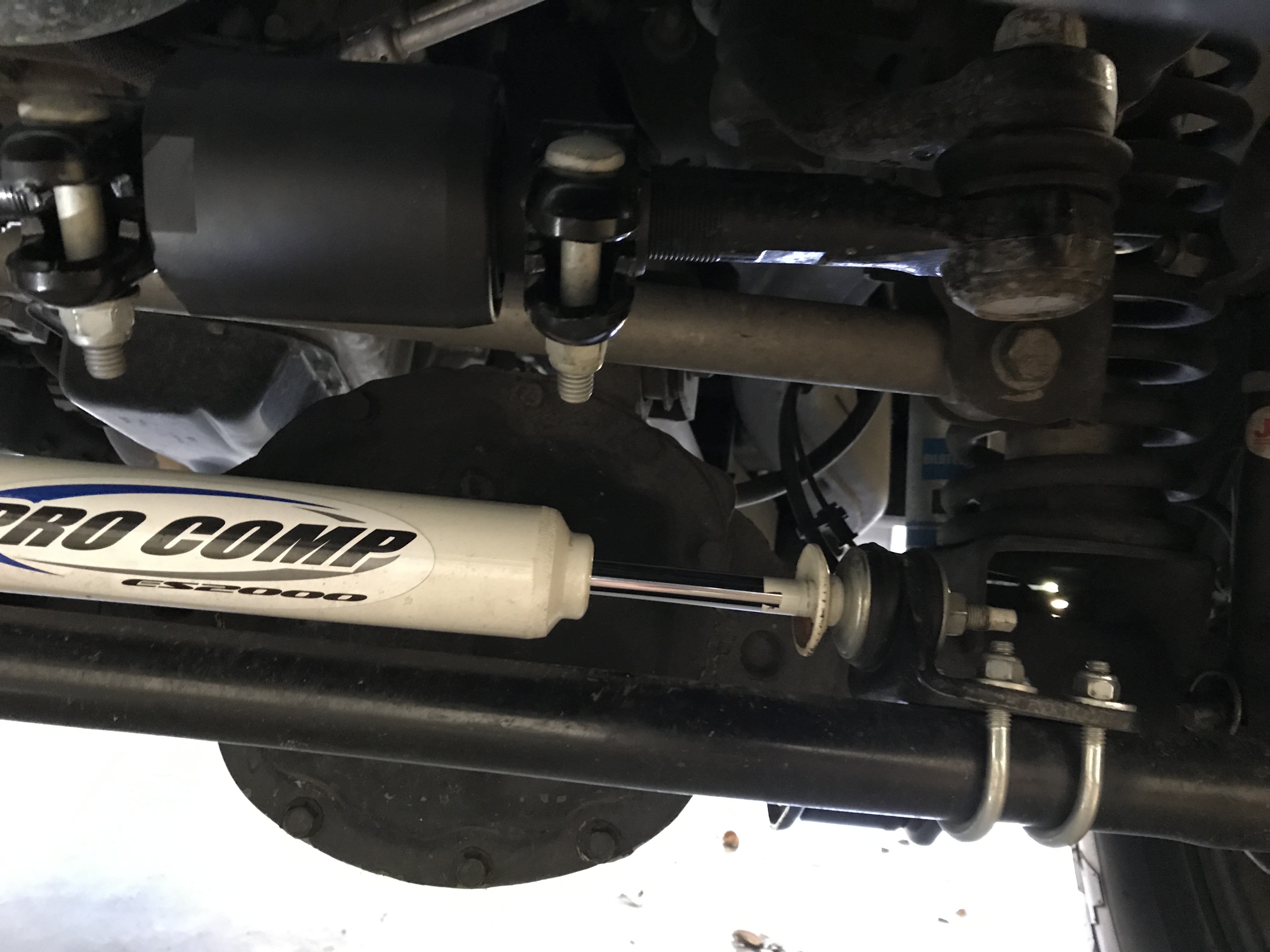

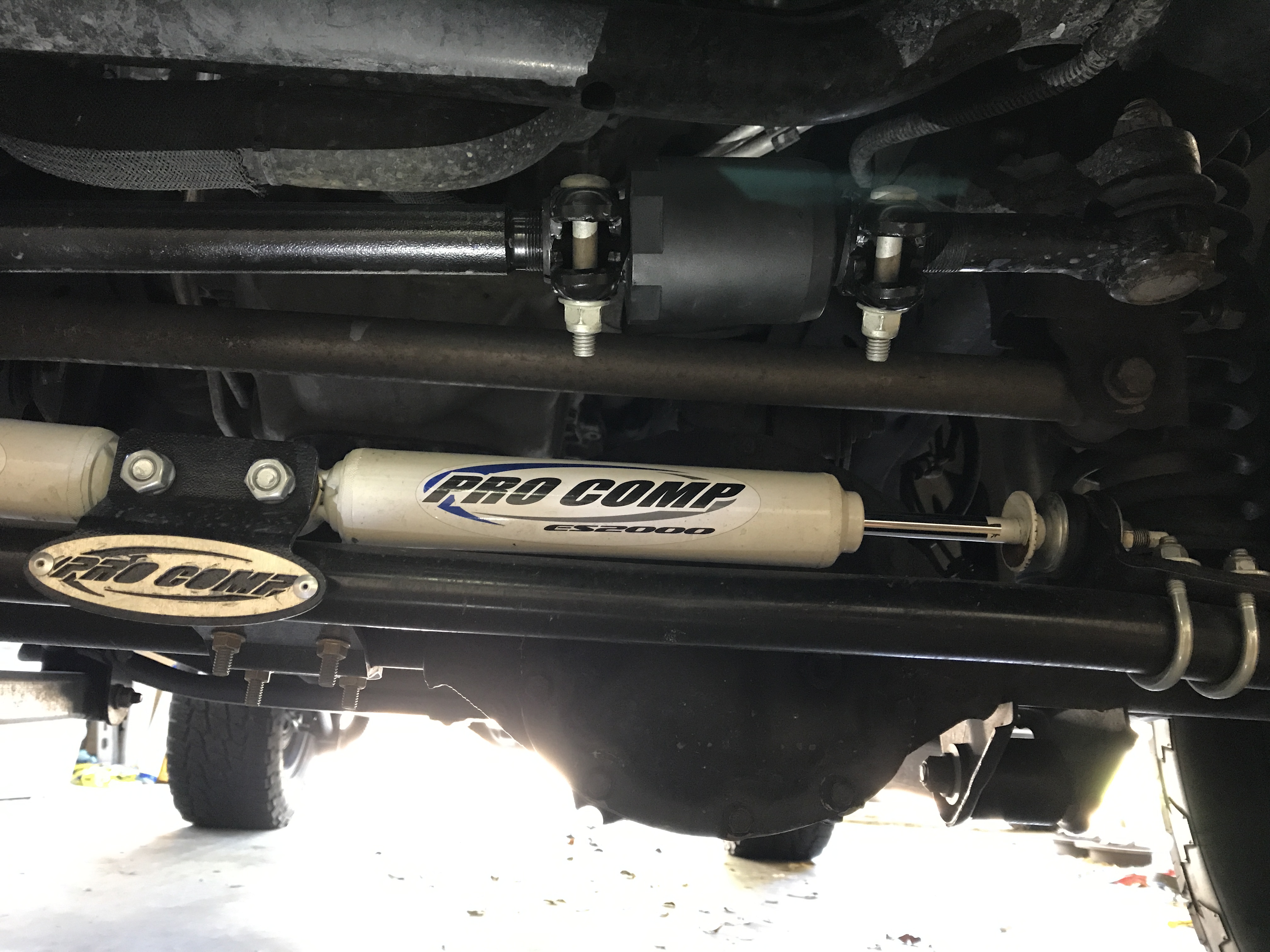

I checked the steering wheel alignment 3 times it is center and there is about 1 3/4 turn each way so I feel like it is centered. Here are some pictures to see if you guys see something I don't

I don't think it is related to your drag link flip. Do you have a procal. I believe it has a steering wheel alignment feature. Did you strap your steering wheel to the seat to prevent it from moving when you disconnected the drag link?

Check your wheel sensors. I promise your DL flip isnt causing that.
