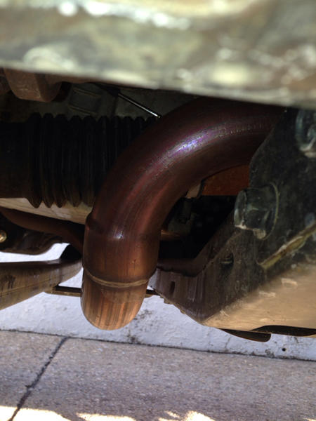

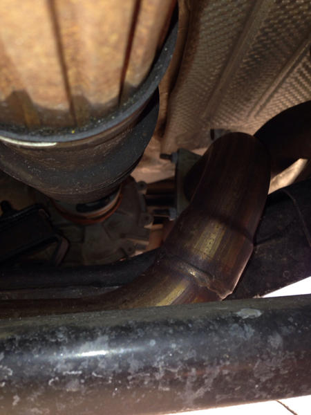

Installed my rancho pipe kit and driveshaft clears by a mile. Also welded the bottom cut. Didn't like the clamp underneath the tranny pan. And clamped the top cut. Just in case I wanted to upgrade my exhaust it wouldn't be a pita to take out.
Now at least I can wheel with out worrying about driveshaft issues. It clears the cross member by an inch and clears the pipe by 3 inches. Greatest $50 investment I made so far.

Looks great. What did you use to cut the pipe?

Sawzall to the rescue!!!

Cool thanks. I was thinking sawzall has to be the easier than a cut-off wheel at that angle.

I took that whole section off. The directions recommend taking that whole middle piece if exhaust off before cutting. It makes it a lot easier. It's pretty easy, they give all the measurements where to cut.
And welding the front cut instead of the clamp is a lot better. I just didn't like the clamp under the tranny pan. I think this set up is better then spacers, where they only move the exhaust back about an inch. This set up actually drops the pipe totally out of the way from driveshaft.
