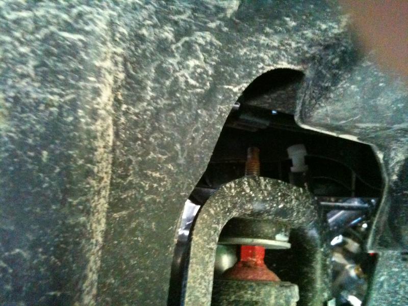

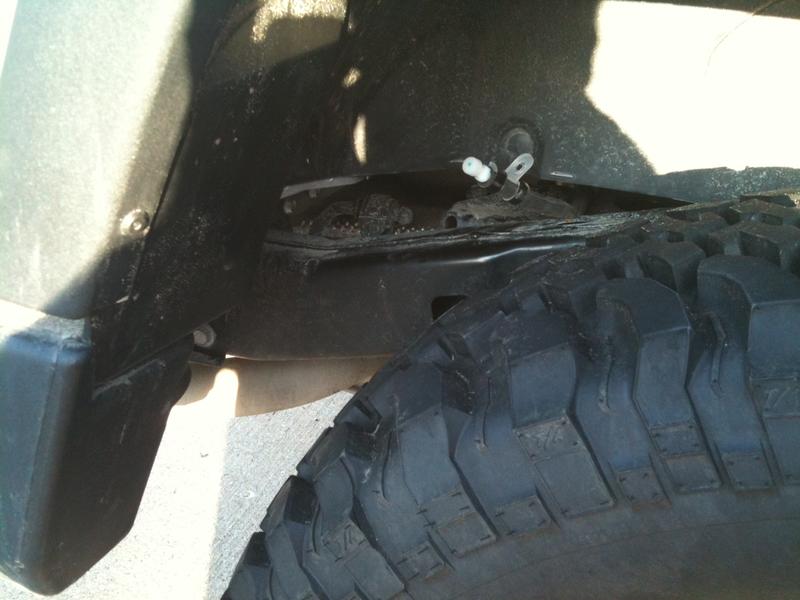

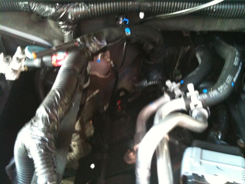

These pics are from my '12 Rubi Unlimited w/manual tranny. Should be the same as earlier JK (non-automatics)
Front Axle: All-white cap located behind the front left (US Driver) upper shock mount:

Rear Axle: All-white cap located behind the frame in the right (US Passenger) wheel well:

Transfer Case: Cap (white base w/green top) located along the firewall, down and to the right of the positive battery post (attached to wiring harness coming up and towards the battery).

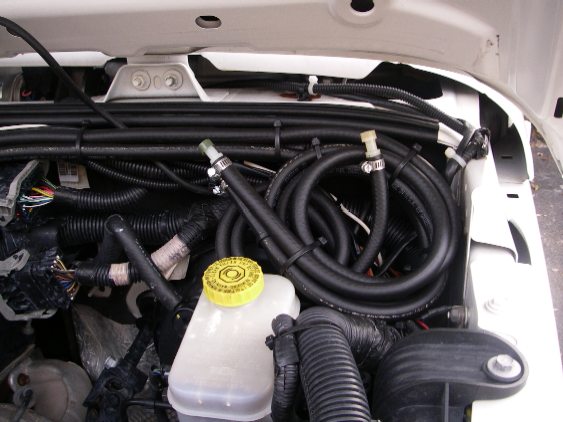

I used transmission line and I ran my transmission and T-Case with there own lines (PIA) and front diff.
The rear diff I ran up and coiled it the right tail light.
