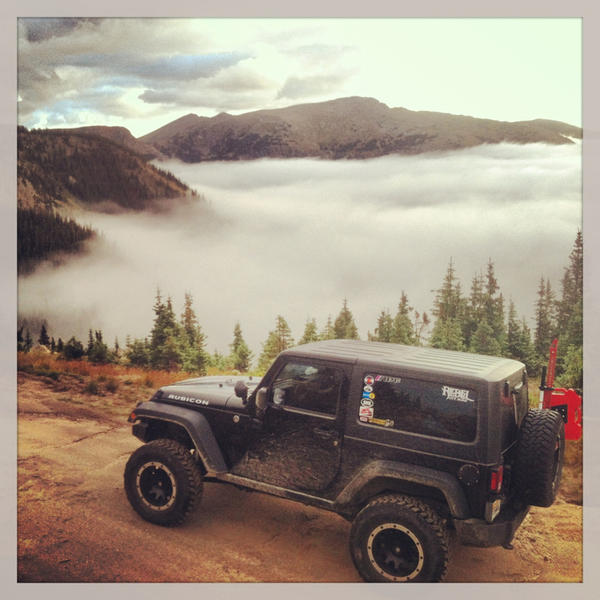

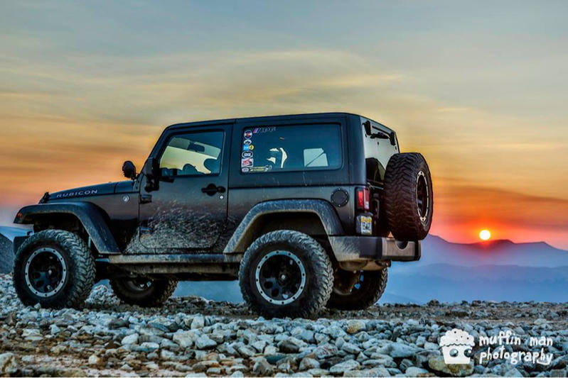

I would like to hear feedback on my build path. I have been on 33's, building to 37s. I want 37's as opposed to 35's for axle clearance (lots of rocks in CO) as well as ride comfort on the trail, I'd love to drop several more PSI and still have some cushion before rim damage.
I'll start with a little info about me and my JK. I have a 2 door 2012 Rubicon that I bought new, and drove and wheeled stock for a year before any real mods. This previous summer I wheeled about every weekend, taking one off here and there. That being said, this is my daily driver and I live in Denver CO. Currently I most prefer trails around the 6-8 rating, 9 if there are bypasses, but I always enjoy an easier rating if there is scenery. I don't have a far commute, but who knows, that may change.
My current setup: 2" OME coils, regular duty. I've added some armor and measured my actual lift height recently to be 1 and 7/8". These are with 5100s. I have JKS track bars front and rear, with a welded on axle side reinforcement in the rear mount. I've added upper gussets to the front C's, and will do sleeves and probably BJ's this month (before the 37's)
My wheels are aluminum 17x9 with 4" BS, currently I have STT 285/70/17. I don't run bump stops other than factory. I'm running the TF hinge and mount for a tire carrier, ARB stubby front with Zeon 10-s, and ORF sliders with rocker armor.
I will trim the pinch seam in front of the rear tire.
I plan to cut my fender flairs until I can go with aluminum crushers. I also plan to add the Evo Rockstars for rear lower CA mount skid and shock relocation.
I will add a rear bumper also, which leads me to my next question: Should I upgrade springs? I could easily make a switch to OME HD or...? (still stock CA's and steering)
I have stock 4.10's. I don't want to regear this year at least, it will be a while before I can afford chromo too.
Thanks for reading all of this if you did. I switched to my computer to type this out, I'll post with my phone in a minute to add some pics.
Thanks for any intelligent, informed, and non-repetitious or obvious input you may have.
Happy New Year.
