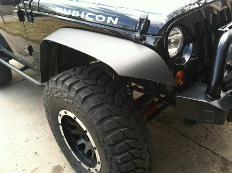

Trimmed fenders.

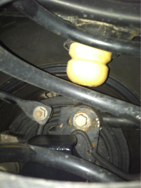

I needed to add bumpstops obviously
I also trimmed fenders but I posted pics of that.

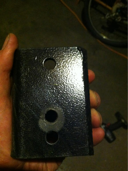

Since the currie arms moved my axle back and rotated it, the bumpstops I was adding weren't aligned.

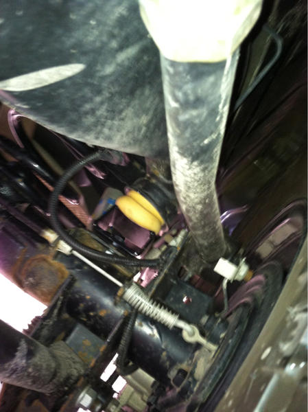

So I drilled a new hole and mounted it with one bolt Instead of 2, about 1" forward.
Sorry, if I didn't mention, this is rear axle I'm talking about.

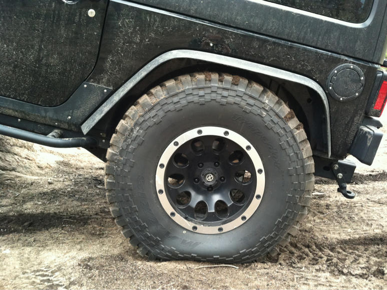

You can see with this bumpstop extension, and cut fenders, lightly trimmed pinch, the rear is doing quite well.
