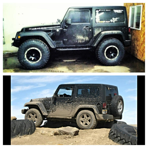

Thanks! This is the progress I've made in 1 year of modding. I drove it stock from 2012-2013 then started modding it one year ago exactly. Obviously much more than you can see but...

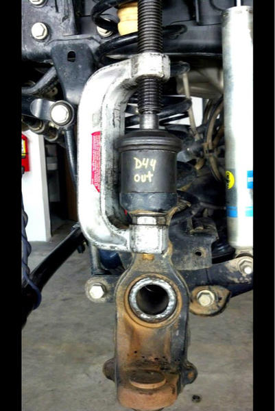

Here's sleeves and ball joints being done.

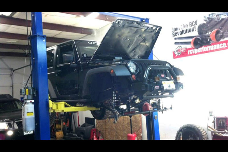

The rear axle was rotated back to correct piñon angle, now my coils run the trackbar so this weekend I'm having the coil perches cut off, rotated and welded back on. I will also remove the rear bumper to prevent rub. I still need to trim flares.
