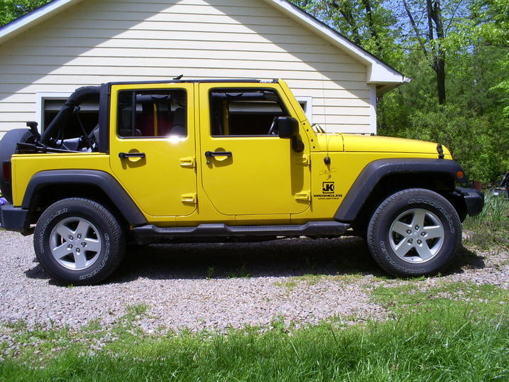

yeah a real easy install, less than an hour. I installed 1 3/4'' spacers, less the factory spring pad, for a total of 1 1/2'' lift. It leveled my 4dr X perfectly. I ordered them from RE.
