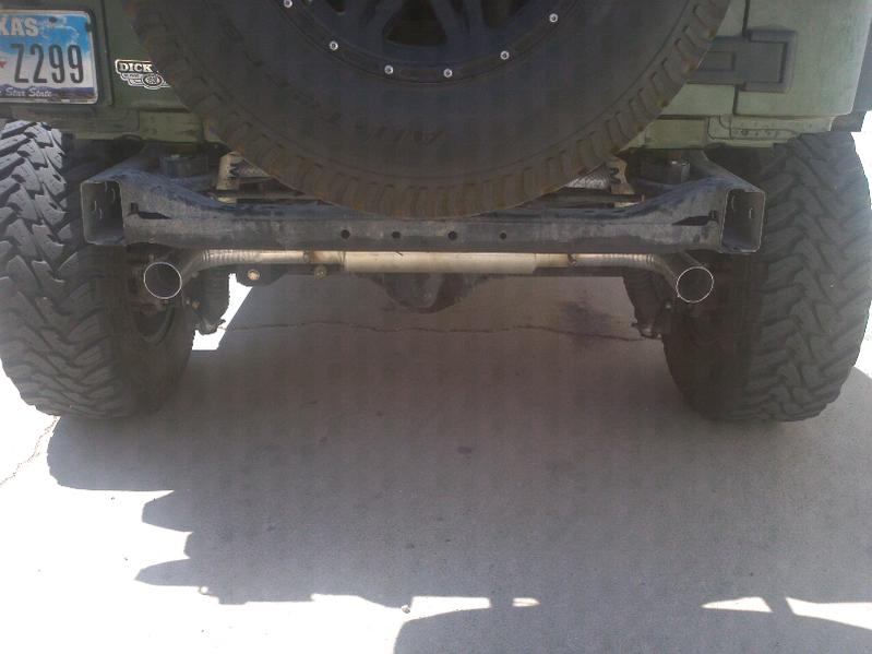

Just bought the muffler from the video. Perfect sound. Flowmaster 80 series 42583 or 842583 for stainless steel. This muffler is used for Camaros but has the same 2.5in inlet as the jk so it works. Love the dual exits. Easy install.
Hey Moz, did you do the muffler alone to get the same sound or did you do the resonator? I'm guessing it bolts right it even though it's used for Camaros? Thanks.
I just replaced the muffler. It sounds awesome! Not too crazy, just right.

Originally Posted by Pete1971
x2 on this any other mod's or just slap the muffler on ?
Just the muffler. I bought the same muffler I saw on YouTube for 99.99 at pep boys. I also bought two L shaped 90degree elbows for the exhaust. Took it to a weld shop and they welded it on for 100.00. My jk is 2008, it'll work with any jk.
