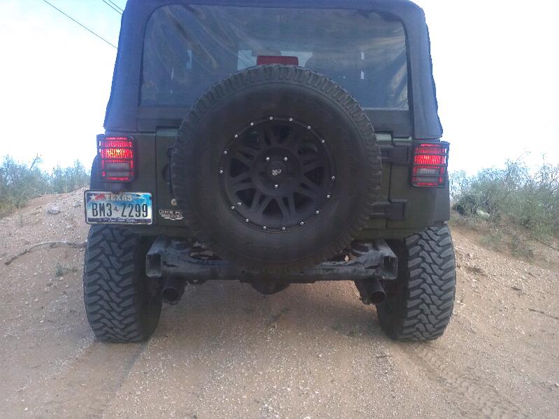

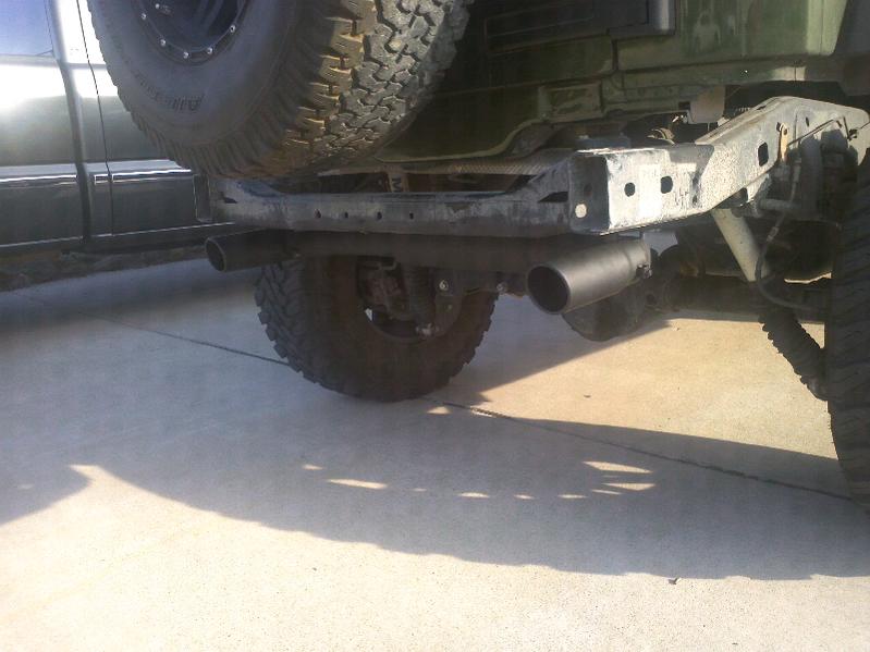

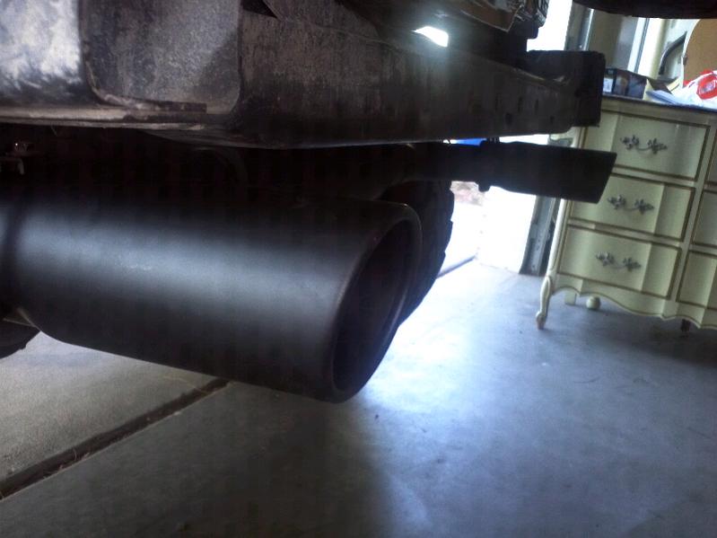

Flowmaster part#42583 or 842583 stainless steel Muffler-$99.99 at pep boys, two 2 1/2 in wide 90 degree L shapped elbows $15-pep boys, two matt black 2 1/2in inlet tips 45.99 autozone, $100 to have welded. Total $265, even cheaper if you know someone who welds. Used matte black high temperature grill spray paint to paint the pipes and muffler.

Nice! Thanks for all the details and pics.
