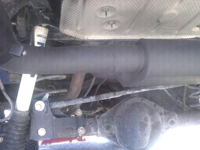

Originally Posted by moz832006
Flowmaster part#42583 or 842583 stainless steel Muffler-$99.99 at pep boys, two 2 1/2 in wide 90 degree L shapped elbows $15-pep boys, two matt black 2 1/2in inlet tips 45.99 autozone, $100 to have welded. Total $265, even cheaper if you know someone who welds. Used matte black high temperature grill spray paint to paint the pipes and muffler.
<img src="https://www.jk-forum.com/forums/attachment.php?attachmentid=355680"/>
<img src="https://www.jk-forum.com/forums/attachment.php?attachmentid=355682"/>
<img src="https://www.jk-forum.com/forums/attachment.php?attachmentid=355683"/>
<img src="https://www.jk-forum.com/forums/attachment.php?attachmentid=355684"/>
Do you have a picture from under your jeep. I want to see how you did this. Thanks

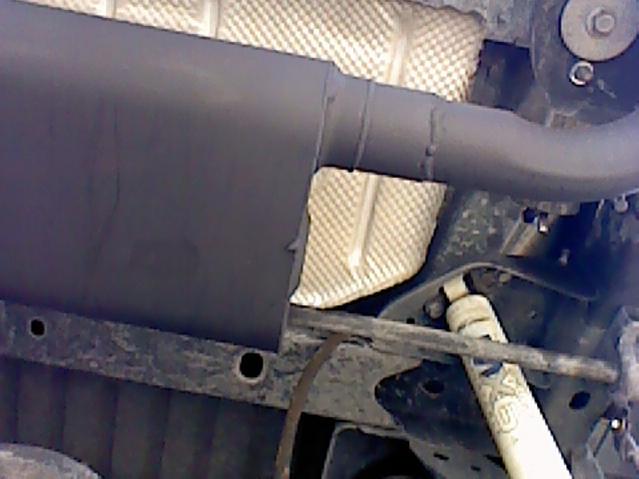

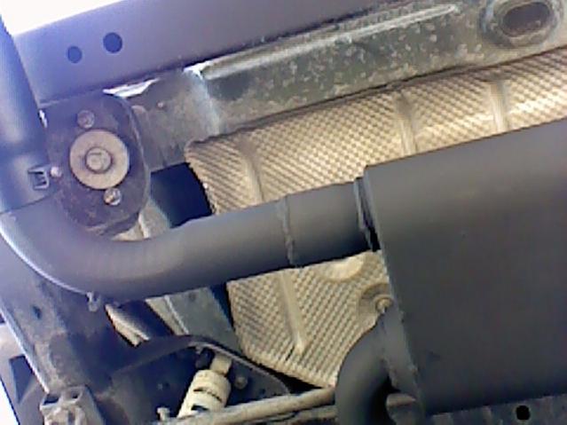

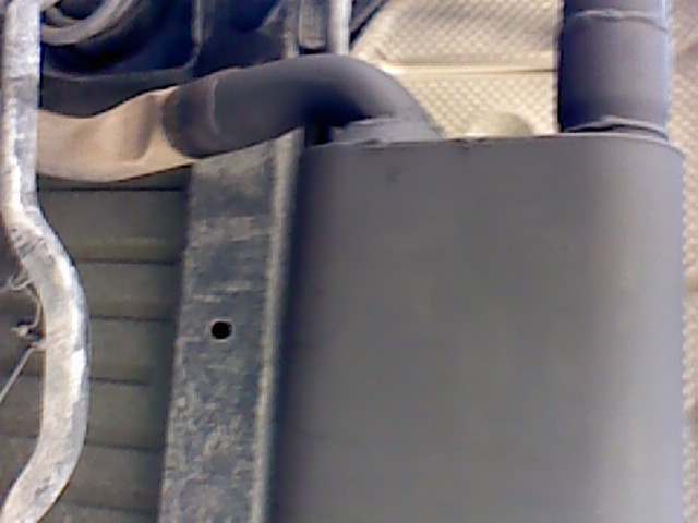

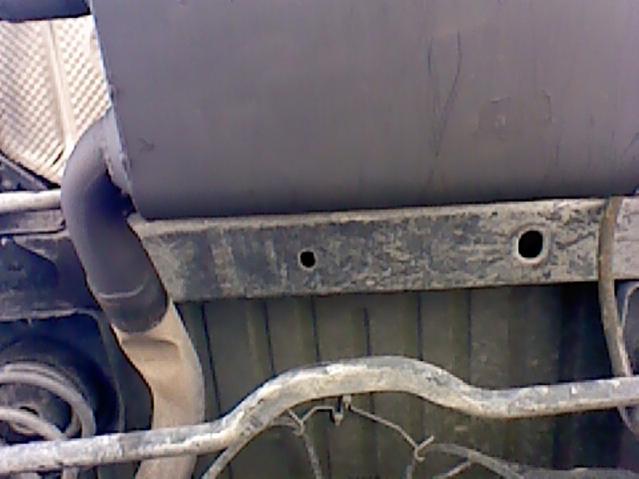

This is how they did it at the muffler shop. The tips aren't welded on yet. Let me know if you want me to zero in on something.

Old Aug 21, 2012 | 01:09 PM
  #47
Redjk777's Avatar
Posts: 375
From: Old bridge nj
Thanks. Perfect.
