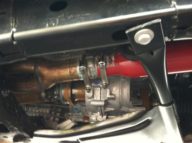

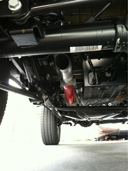

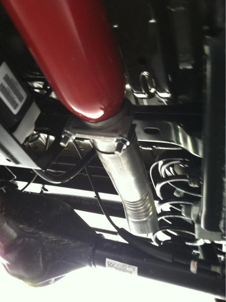

Just a hack job I threw together in like like 10 min lol....
ID:	359256   Click image for larger version
ID:	359257   Click image for larger version
looks good . I'll probably just take off the muffler and see how it goes, we pulled out the muffler for my bro's 09 it sounds good. I hope the 12 sounds just as good, i know its a different sound though.
Can you give us a parts list. What cherry bomb is that. And how dose it sound. I just took the muffler off and I don't like the sound it's too ricey.
Just an 18inch 2.5inch in/out glasspack, it's actually a thrush brand and not cherrbomb. Used a 2.5-2.5 connectors and a 2.5inch turndown.
-for those taking the stock resonator off lower the transfer case skid, helps out immensely in removing the pipe
