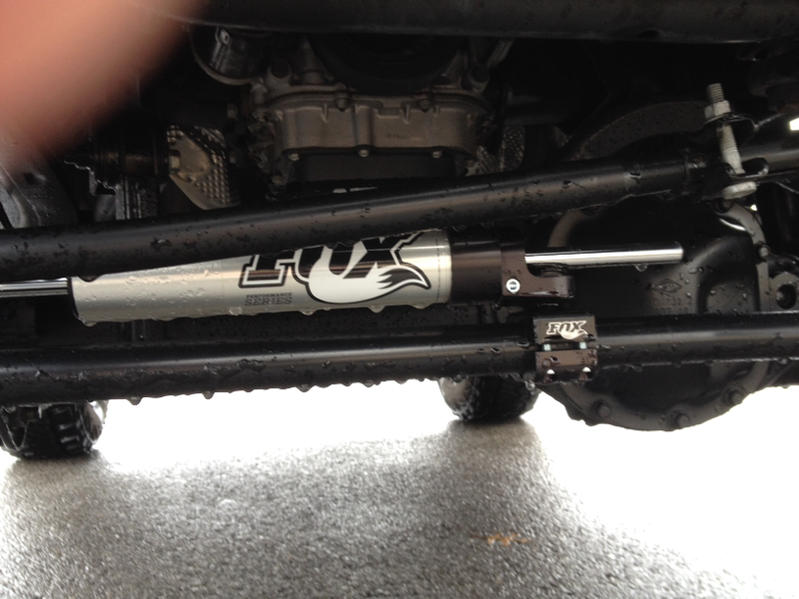

the kit isnt complete it dosent come with the track bar bolt that is extra ! you must admit that it does have some vulnerablity as shown in this photo id want them to include a protective device for $360.00 or id look into the bracket also (that through rod buggs me , id be most worried of that getting bent on the right side of shock even a small nudge and id imagine that shock is toast though it would take a certain situation and you prob would damage other things as well at that point

Even with a bracket it still attaches to the tie rod. The kit fox provides is complete. Shouldered track bar bolt, ats steering stabilizer, tie rod mount, and hardware. Happy with my purchase! Of course anything can get damaged. That's the risk you take off-roading any vehicle. I don't see where an inch moved one way or the other is the determining factor on buying this shock. Mine sits where it was designed to sit and makes no contact with anything, so unless I hit something it's fine. That won't change no matter where you put it. This shock does improve drivability. Steering wheel stays steady

btw ~ jls jk can you post a pic of how yours sits under there ? nice jeep

Here you go. Mine only has 19/59 springs. So it's not lifted high and there's not a lot of room in there. I have flexed it and had it offroad probably 4-5 times this year and it makes no contact anywhere. Closest to the tierod, so if the tierod were to take a hit it could be trouble. There's just not a lot of rocks here, just trails. I could get away with adjusting it back towards the trackbar a bit, but like I said before an inch or so isn't going to make much of a difference. Hopefully you can see it clearly with these pictures

The draglink looks close in these pictures, but it's rotated down and it's probably an inch to an inch and a half from the stabilizer. I've tested it a lot and the closest anything comes to it is more than a fingers width. I've flexed it, turned the steering wheel both ways and you can easily slide your fingers around the shock. So there's not a lot of clearance, but nothing comes in contact. Atleast not yet. Like I said there's more than an inch all around it. More in the back towards the trackbar.
