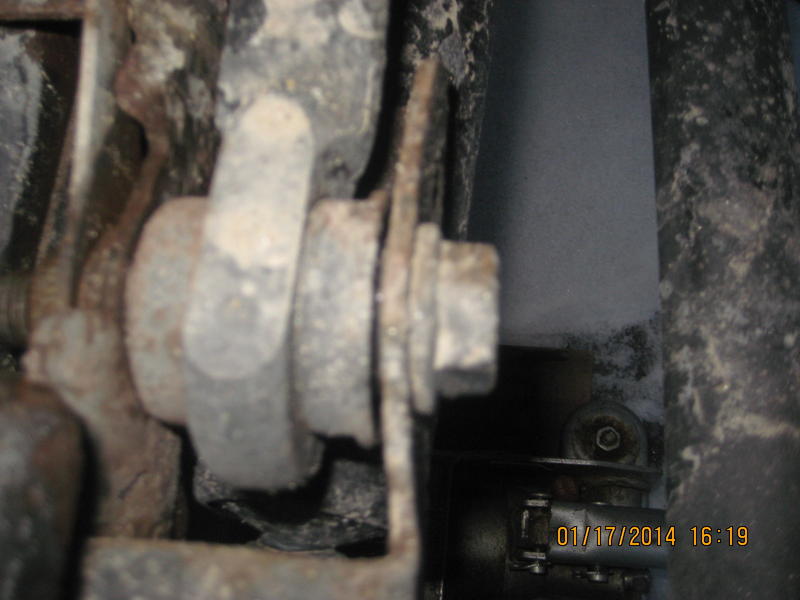

what paint do you use rustolium black gloss i used rustolium ruberised under coating when i got it and then went over and over every spring then in fall again too some times but it just pealed i mean check this out
i paint it all over when it gets this way but rust just gets everywhere under there and no matter what i use it appears im wondering about that rust reverser type stuff that turns dark then hit it with the paint like your using and yeh ill be adding the set up like you have most likely if my front sags from my poison spyder mid front & skid that weights in at 135 lbs
thats why i was interested in this ats shock i want to keep everything tight mine steers perfect right now no drift, wheel is tight as a drum . i almost hate to raise it at all with stiffer springs , due to the issue you mentioned about being flighty

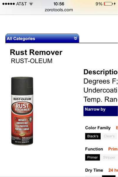

I use this stuff after I steel brush and wipe down with a damp water and alcohol cloth. Let dry a few hours and then rustolium black gloss. I do pull the tires and put it up on jack stands just because it's a lot easier to get to everything. So I usually do it when it's time to rotate the tires. Drop it down when finished and then get the frame rails and whatever else before I run out of paint. I spray everything except coils. It definitely helps and the gloss dulls pretty quickly.
can you just use plain bottle of alcohol seeing its cheap enough or does water do somthing besides make it go further ? thanks for this info ive been wondering what to use now , seeing the methods tried using undercoat spray and bed liner dosent hold up ! how do you get the tight areas cleaned from rust or just spray than in there and later hit it with paint

I'm not a pro, but use the regular alcohol. Squirt a carpenters rag with it and then wet the rag to get wet. My thought was the alcohol just helps it dry quicker. I don't necessarily get it clean but I wipe it all down after brushing. And yeah I can't get to everything so I just spray away. I used the rubberized stuff on my grill and it's starting to peel. It's going to have to be redone. Let me know what you think when you get the fox. Mine did have rust. The tie rod was rusted under the stock clamp. So I sprayed it all before installing the stabilizer.
