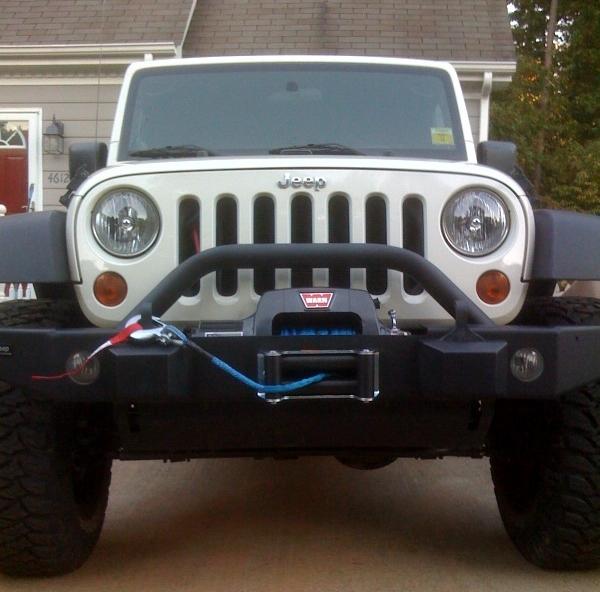

heard the sensor is inside the vehicle and crush cans are supposed to reduce impact - but not sure how much 2 coffee cans will slow impact from a 3-5K vehicle?
check out the MOPAR bumper - most dealerships with give you a price well below aftermarket bumpers and the MOPARS look and perform great - no rubbing and they do have coffee cans.
