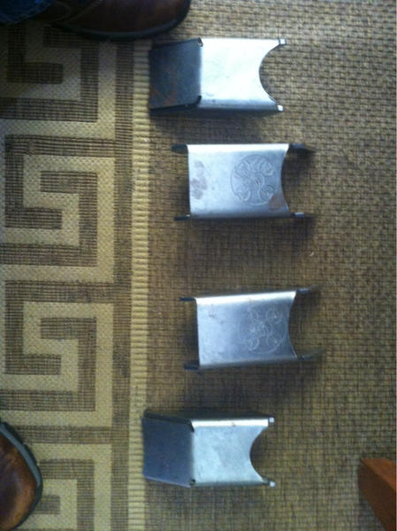

Evo c-gussets came in today. Going to order sleeves and will install them at the same the same time if the price is right. Click image for larger version
