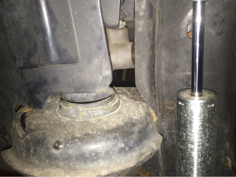

Silly question, anyone who suffers from this annoying sound, is it possible it's the lining inside the wheel-well?
I noticed some wear and tear in areas around that plastic and just maybe it might be this? Any feedback would be great. Also has anyone taken all of that stuff out? Any regrets? Anyone take it out and still have the infamous honk sound still? Thanks again for your insight!
