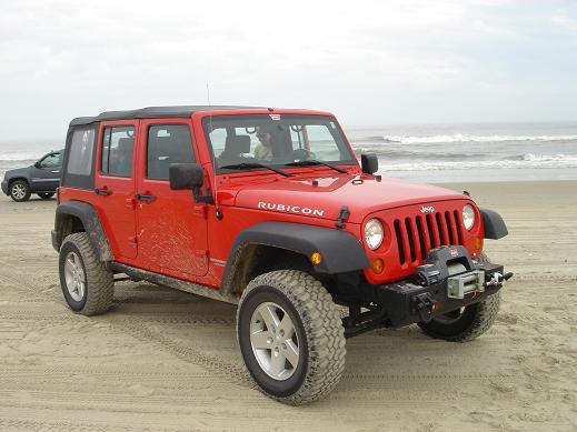

Here's what it looks like if you have the TF BB2.5" installed and add the TF 2.5" coil springs http://www.teraflex.biz/products/jk-...ront-pair.html. nothing was removed from the BB kit except the sag
Name:	DSC00600 - Copy.JPG
Originally Posted by HG97TJ
I'm thinking you'll still have some front end sag with just the front 2.5" springs given that you back is still up 2.5" with the spacers. Yes the fronts springs will give you a bit more than 3" less the sag from the weight of your bumper winch so you may end up where you are right now. The rear TF coils (had you gotten them too) only lift the rear 2" with this kit which helps level the Jeep. You may end up wanting a 1" spacer on top of your new front coils to get it where you want it if you just get the front 2.5" coils. Joe...thoughts?
FWIW - Teraflex used to sell an optional HD Budget Boost that would simple use a 3" coil in the front with the 2.5" spacer in the back to compensate for added weight in the front.
I never removed the front spacers, they are still installed.
