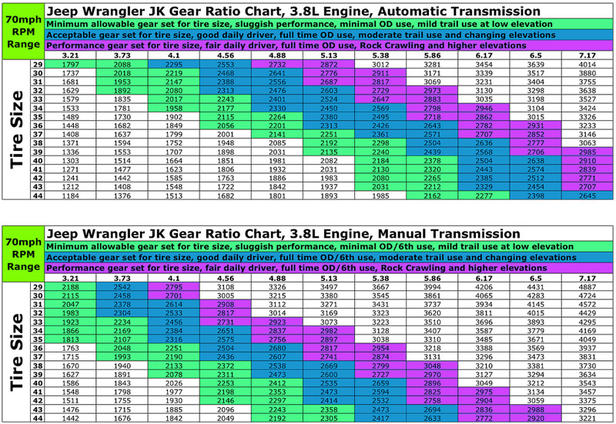

Yes, you'll be okay, but you could go 5.38 as well.
Name:	JK Gears.jpg

More information would get you better answers. 2dr or 4dr, auto or manual, mostly in town or mostly high speed freeway, towing, axles (D30/D35/D44), added weight/armor, stock flares or flats, disconnecting, fire roads or flexing in the rocks, whatever else may be relavent.
